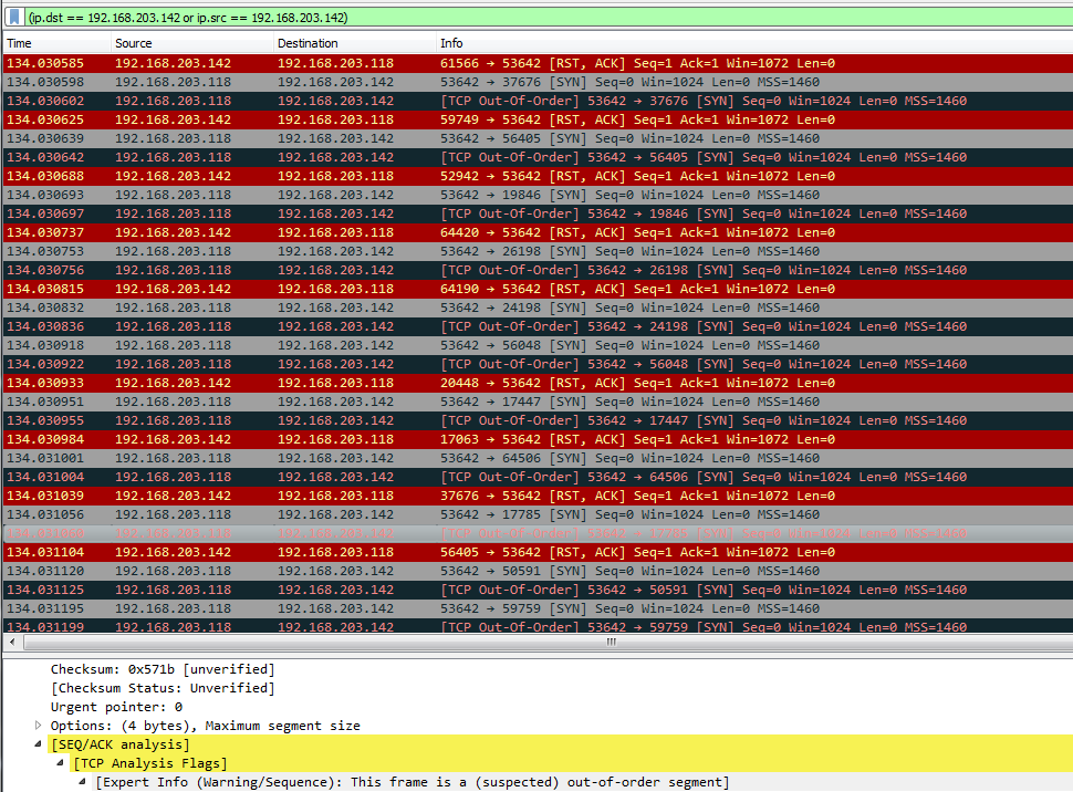

Everything worked fine until our client submit our card to a IP vulnerabilities tester : during the test the card stop responding to ping.
The test consists to try a connection on random TCP ports, about hundreds time each seconds... Please see below wireshark screen shot.
By looking deeply in the source code, it appears that ETH_IRQHandler() is no longer generated in that case. So ethernetif.c/ethernetif_input() stay blocked on osSemaphoreWait() call indefintly.

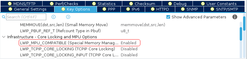

Another change that seems to have helped is to enable the following advanced parameter:
LWIP_MPU_COMPATIBLE
