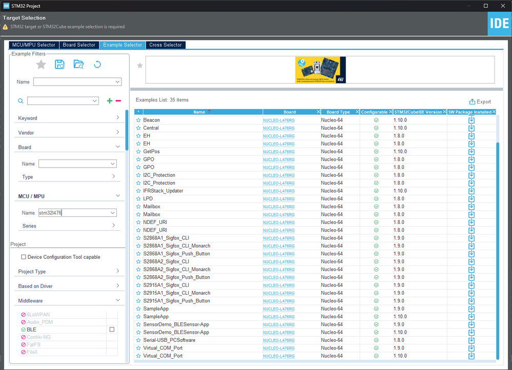

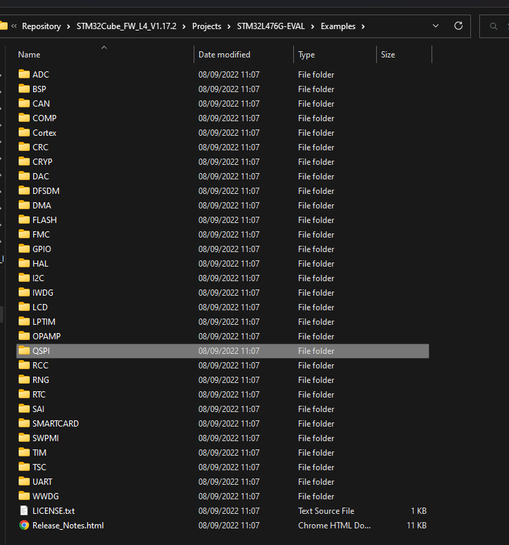

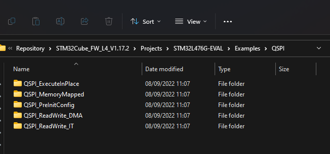

0693W00000SvtWcQAJ.pngHi @Imen DAHMEN​ ,
I'm experiencing a similar issue.
I have the latest pack for the STM32L4 downloaded (V1.17.2). I can see but a few examples for some of the L4 MCUs in the repository, and some of the MCUs are outright missing in the example selector.
In the repository folder, all the examples are present.
See the attached screenshots of both STM32CubeIDE and the repository folder in Windows. I have highlighted the QSPI example in particular for the STM32L476.
I'm using Windows 11 build 22621.521 and STM32CubeIDE 1.10.1.
Thanks in advance
(EDIT: Apologies for the scattered screenshots, the forum website only allows one attachment, and when inserting images it inserts the third image at the top for some reason).
