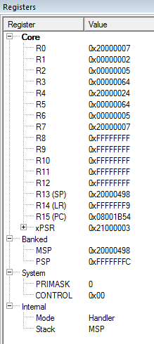

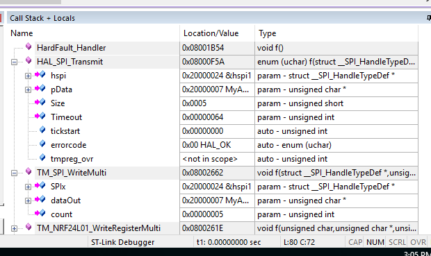

I've got a project build on custom PCB around STM32F051K6T6. There are a couple of other things on this PCB: ULN2003 driver, CD4511B driver , TLV73333 3.3V regulator and the main ''problem'' NRF24L01+ module, connected through SPI1. Board peripherals and init code are generated with CubeMX software. So far everything worked just well: PWM on gpio, timer 6 for some periodic interrupts, CD4511 7 segment driver... When I tried to connect NRF24L01+ through SPI with custom library (modified tm_nrf library) using SPI HAL drivers, strange things happen. uC halts in Hard Fault Handler after a few SPI transmit and/or receive commands. It halts at in stm32fxx_hal_spi.c file in function

... and than halts at HarFault_Handler. 0690X00000605FGQAY.png 0690X00000605QwQAI.png 0690X00000605QmQAI.png This is my first HardFault ever, so I don't really know how to handle it. I've google it alot, tried tochange stack size and played with other SPI settings, but with no success. The same NRF24L01 board works with Arduino, so there must be an error somewhere in my code/pcb. Let me know what additional informations are needed. Thanks! #hal #spi #cubemx #hardfault

Breath! Breath! ;) Well I usually examine the disassembly in the vicinity of the offending instruction, plus the state of registers at that moment. We lack that at the moment but if it's true that it's related to this line:
hspi->Instance->DR = *((uint16_t*)hspi->pTxBuffPtr);
then chances are that either
hspi->Instance
points to some funny place or, maybe more probably,
hspi->pTxBuffPtr
is not aligned properly (Cortex-M0 can't perform unaligned accesses). It may be worth noting that there are more faults than just the hardfault, indicating the nature of the fault further, but most of the time there is a common vector for all of them, so you lose that information. > works with Arduino, This word is not to be used in a decent society. JW

8-bit should always be fine, the problem with 16-bit and 32-bit is going to be unaligned addresses, you can't read 16-bit values from ODD addresses. You need to manage carefully the buffers handed to the routines.
