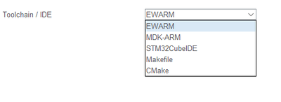

STM32CubeMX generates by default a xx.ld file.
It has copyrights from 2023. However, if I set "Apply Application Regions Settings to Linker File", it will generate a file with 2025 copyright, different template, also with XX.ld case, which on Linux, will give issues.
Version 6.16.1

Could you please explain what issue you are facing because of this behavior?
Its the inconsistency of the case in the file name.
Eventually, I can workaround it and it wont cause issues, but:
STM32CubeMX by default generates a MCU_xx_FLASH.ld file.
With "Apply Application Regions Settings to Linker File", it will generate a MCU_XX_FLASH.ld
STM32CubeMX cmake uses MCU_xx_FLASH.ld file.
On Linux, case file name matters.
I have to delete MCU_xx_FLASH.ld and rename MCU_XX_FLASH.ld to MCU_xx_FLASH.ld (also because I'm already tracking MCU_xx_FLASH.ld), every time I generate code on STM32CubeMX.
Eventually I can start use upper case version

Hello @Mario Luzeiro
To clarify, which of those options did you choose for code generation?
THX
