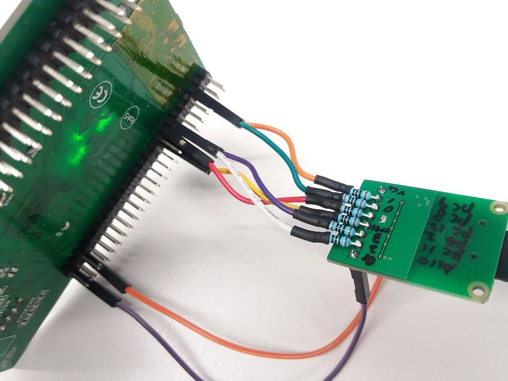

Please can you post the Image of other side of the sdcard board for Soldering reference .also please share the working code since i have been trying from past 3 weeks.(STM cubemx+Truestudio9.1)
Thank you
Ashwinraj
Posted on July 11, 2018 at 09:53
Dear Ashwinraj,
Please refer to following URL and picture.
https://github.com/jason0627/STM32F4-Discovery_SDIO_4bit_OK
Best regards,
Jason
Posted on July 11, 2018 at 10:02
I've spent months on the issue and thanks to Jason, I've managed to make it work. I've found out that I actually need to set DMA and NVIC in the versions after 4.21, so I suggest you to look at the DMA and NVIC setttings.

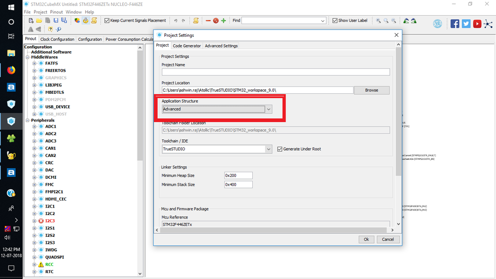

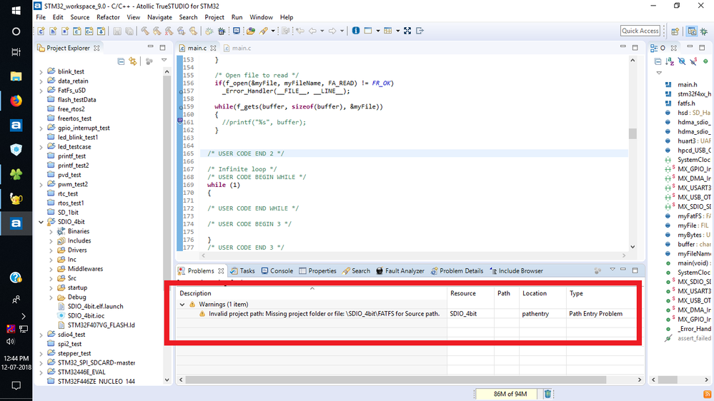

Thank you very much. but i figured out solution for few latest cubeMX4.26
1) Enable DMA
2) use 22 ohm series resistor
3) In cubemx change the application structure to Advanced(check attach image) or else in truestudio you will get path entry warning 0690X0000060M8YQAU.png0690X0000060M8dQAE.png
