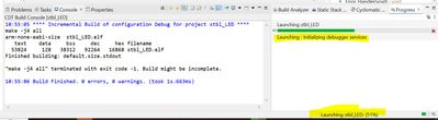

Apr 8, 2025 7:35 AM UTC
Hi @Semer CHERNI ,
I am using STM32F429I-DISC1 board with STM32Cube IDE.
But I see the building every time shows "make -j8 all terminated with exit code -1". Build might be incomplete.
And while starting for Run/Debug, it seems like the flashing to the board is getting stuck.
Could you please help in this case , if I'm missing any tools to install or any specific version of tool will work or any configuration setting to change ?
