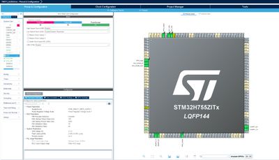

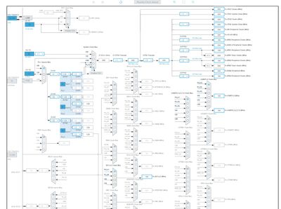

Chip Configuration:
- Selected STM32H755ZIT6 in STM32CubeMX.
- Disabled HSE and enabled LSE with a crystal resonator.
- Set M7 clock to 400 MHz and M4 clock to 200 MHz.
- Power settings:
- Supply source: PWR_DIRECT_SMPS_SUPPLY.
- Power regulator voltage scale: 1.

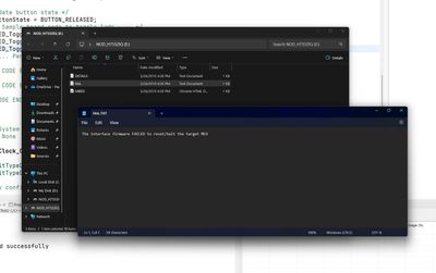

And, Beside the MCU not able to finding it's target, after restarting the device I receive this,
The interface firmware FAILED to reset/halt the target MCU
I’ve rechecked the configurations multiple times and followed the guidelines for debugging and clock setup. Despite all efforts, the issue persists.

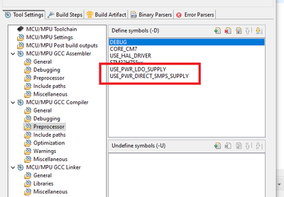

‎2025-01-20 12:37 AM - edited ‎2025-01-20 2:24 AM
Hello @Daniel_Ismail ,
The issue is due to a limitation in the new CubeMx version described in this thread. Refer to the solution.
Two defines of the power configs are generated by CubeMx for the same project:
You need to remove the define USE_PWR_LDO_SUPPLY from the project preprocessor and need to recover your board from the lock situation. Refer to the thread mentioned previously.

‎2025-01-20 10:05 AM
Thanks a bunch @mÆŽALLEm !That solution worked perfectly! I had spent days trying to resolve this issue, and this approach finally fixed it as expected. I'll also add the spinning as suggested by @Tesla DeLorean delay to ensure the setup is even more robust. By the way, will the upcoming version include a fix for this issue?
