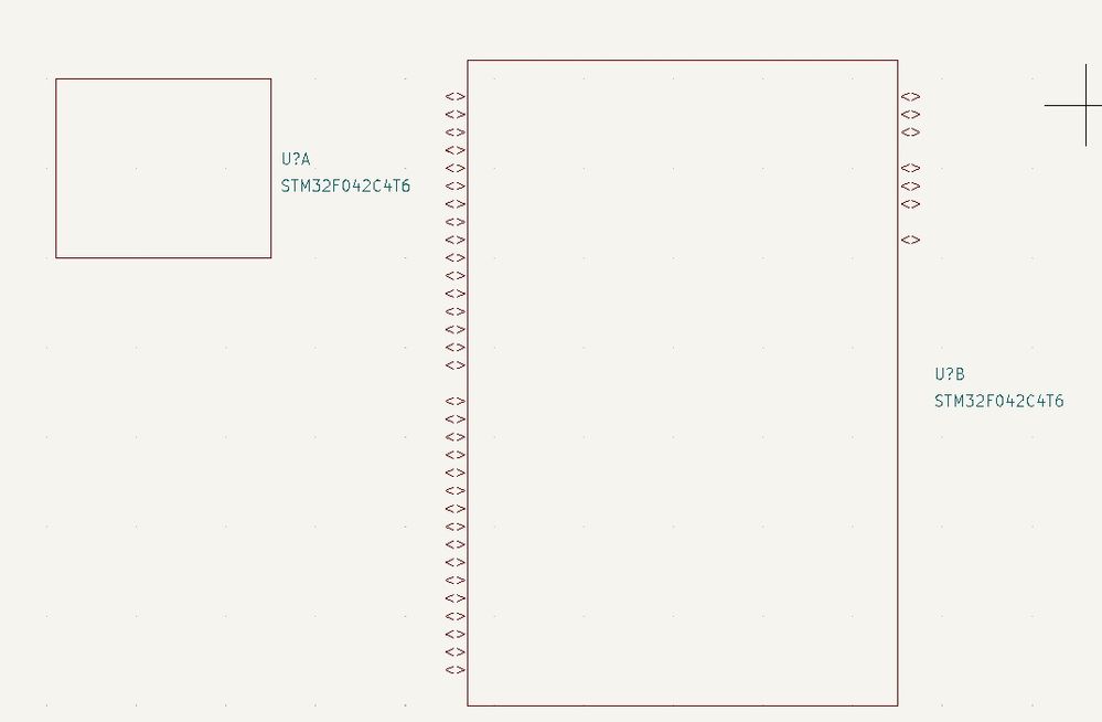

I am using STM32CUBEMX 6.6.1. When trying to export a Kicad model, the model turns out empty without any Pins.

Hello Peter,
I used the TOOL -> CAD Tab.
Choosing Kicad as CAD Product. Export Pins including labels. Then download CAD Model.
The model is generated but includes no connectable pins as shown in the following graphic.
I also checked the generated files. It only contains the information for the shape.
