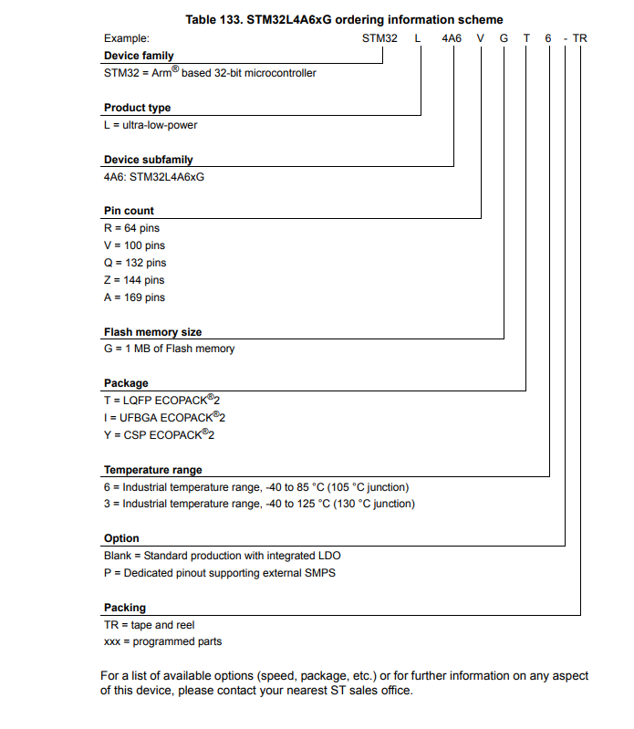

Hello. I always cross reference my projects with STM32CubeMX software ( all up to date and new)
https://www.digikey.com/products/en?keywords=STM32L4A6VGT6P%20
But i can't find this device I am making my project on, did you forgot it ?
Hope you can fix this ST, thank you !

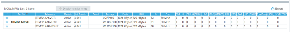

Hello @Linas L​
STM32L4A6VGT6P Device ==> STM32L4A6VGTxP
Best regards,
Nesrine
Linas L
Senior II
I think i know how to search ;)
no lqfp100 package
Hi @Linas L​
I checked again and confirm that STM32L4A6VGT6P is missing in STM32CubeMX. This is reported internally.
Regards,
Nesrine
