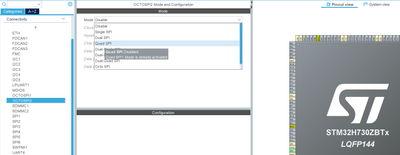

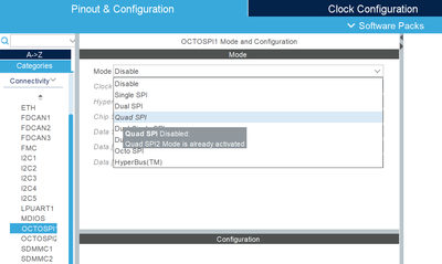

After updating to cubeMX 6.15, I cannot configure OCTOSPI in Quad mode.
To reproduce this bug :
Create a new project selecting STM32H730ZBT6
Select Connectivity->OCTOSPI1->Mode
I cannot select select Quad mode because Quad SPI2 mode is selected ==> Of course NOT
Now go to :
Select Connectivity->OCTOSPI2->Mode
Also cannot select Quad mode in OCTOSPI2
