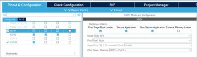

While creating a project for STM32N6 I can’t find the option for hexaspi or octospi for STM32N657B0HxQ . Is there any particular option I have to enable?
I am trying to generate the ioc similar to STM32N6570-DK board .
I am on 6.15.0 STM32CubeMX.
Where is octo and hexaspi option?
also which mode I have to enable FSBL + Non Secure/Secure or only Non Secure/Secure

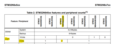

According the STM32N657 datasheet, the STM32N657B0HxQ supports only 2 XSPIs 8 bits (OCTO) and not 16-bits (HEXA)
For the Octo SPI mode, you need to configure the XSPI with Octo SPI mode.
Thank you.

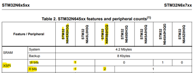

Hello @darla14 ;
The STM32N6570-DK Discovery kit is a complete demonstration and development platform for the Arm® Cortex®‑M55 core‑based STM32N657X0H3Q microcontroller. This package supports 2 XSPIs ( 8 bits (OCTO) + 16-bits (HEXA)). However, you have an STM32N657B0HxQ device that supports 2 XSPIs 8 bits (OCTO). So it is not possible to integrate Hexa memories.
For design  inspiration,  I recommend you to look at STM32N6570-DK design board and Getting started with hardware development for STM32N6 MCUs - Application note.

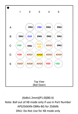

but i want  to ask .lf we can have the above given RAM in 8 bit mode as well(octospi)  as per this https://www.mouser.com/datasheet/2/1127/APM_PSRAM_OPI_Xccela_APS256XXN_OBRx_v1_0_PKG-1954780.pdf
so if am not having graphics feature and want to use it for storing data say images or neural network weights or application code i can use the same variant of STM32N6 for both flash and ram and utilising both octospi.
let me know your comments

As mentioned in the memory datasheet the APS256XXn_OBRx can be operated in X8 mode.
