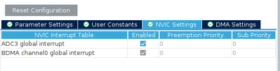

NVIC settings:

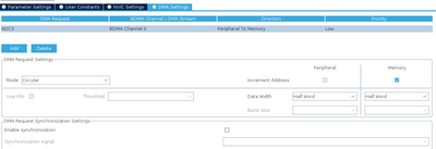

with DMA settings:

BDMA, DMA1 and DMA2 do not have access to the DTCM memory. BDMA has access to SRAM4 in D3 only. Please refer to the reference manual.
Setting the DMA to DMA1 fixes the issue.  Thought I had tried this before and failed, but I must have had other issues in the setup.
