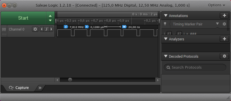

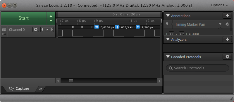

I want to create a simple PWM with changing duty cycle. To do so, I have created a PWM with fixed frequency. With the DMA, I change pulses which will result in a modification of duty cycle.
To create something clean, I have configured STM32CubeMX and generated fresh files (configuration in attached documents below).
If I test my PWM with fixed frequency and fixed duty cycle, everything is working (without DMA). I have not modified files, just added this line to start the PWM:
HAL_TIM_PWM_Start(&htim4, TIM_CHANNEL_4);
Result as expected:

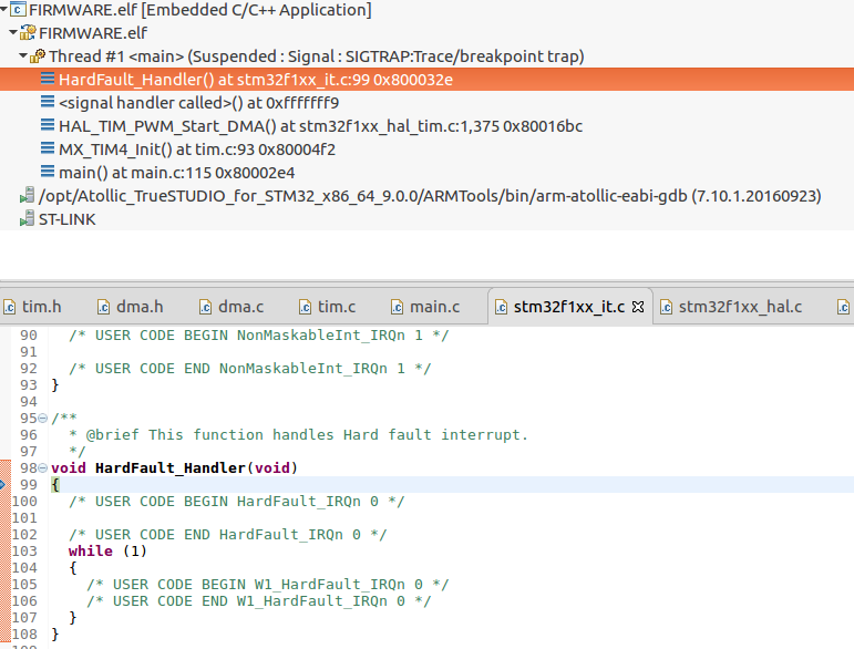

More particularly, it seems to crash at this moment:
/* Set the DMA error callback */
htim->hdma[TIM_DMA_ID_CC4]->XferErrorCallback = TIM_DMAError ;
Maybe I am missing to do something...

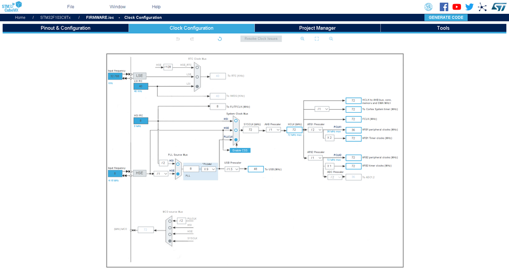

see your external crystal frequency is setup correctly if it is wrong then hard fault occurs in MCU.
Thanks for you answer, but my problem does not seem to be related to any crystal frequency error as everything is working correctly except when I call the DMA.
My crystal seems to work correctly
And STM32CubeMx is set correctly:

VDELA.1
Hi Geo En
I faced exactly the same issue on BluePill STM32F103CB, when trying to generate a sawtooth on PB9 (Timer 4 CH4 PWM) for ADC dithering (but that's another story).
From my understanding, CubeMX generates wrong code line 76 of tim.c
It is
  1. __HAL_LINKDMA(tim_baseHandle,hdma[TIM_DMA_ID_UPDATE],hdma_tim4_up);
whereas it should be:
  __HAL_LINKDMA(tim_baseHandle,hdma[TIM_DMA_ID_CC4],hdma_tim4_up);
Once this line manually fixed, the bus fault disappears.

Yep, this is exactly the problem. We don't set the good pointer. So the library use a pointer = NULL and try to execute a function = NULL...
The problem is: we don't have the possibility to use the good pointer in stm32cubeMx. Maybe because that's impossible physically, or maybe because I have made a mistake, or maybe it is a bug in cubemx. Who knows? as there is no description at all in this wizard...
