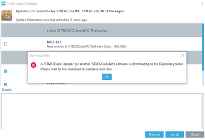

I want to update STM32CubeMX and STM32Cube MCU Packages, but I can't do because of the error.
I tried to run STM32CubeMX in admin mode, but the error occured again.
1. How do you solve this error?
2. Is 'STM32Cube Updater' a real file?
# Error Text : "A 'STM32Cube Updater' (or another 'STM32CubeMX') software is downloading to the Repository folder. Please wait for the download to complete and retry"

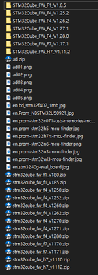

# In the Repository folder
StrangeTau_1-1744693678480.png What file is being downloaded?

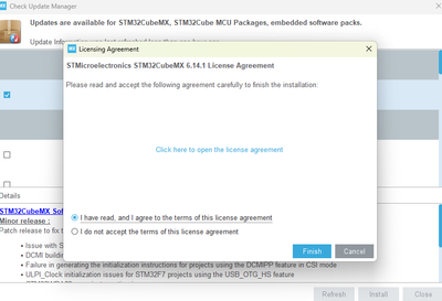

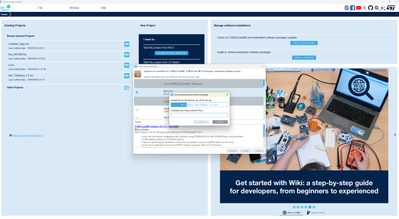

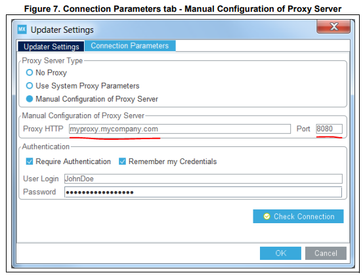

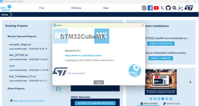

Make sure that you are connected .Go to Help --> Connection and Updates then follow the steps mentioned in UM1718 :3.4.2 Updater configuration.
Next go to Help and press "Refresh data".
Finally click on "Help "--> Check for updates --> MX 6.14.1 --> install

Sounds like you have multiple programs open trying to update. Close them all and retry.

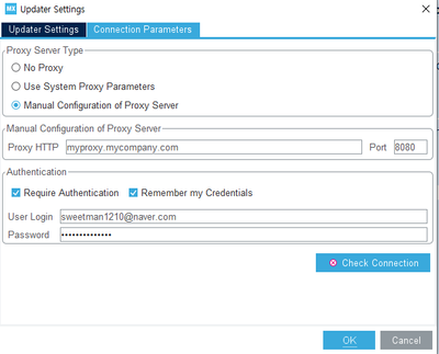

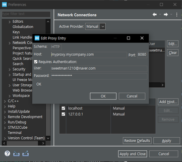

Hello @Ghofrane GSOURI
Thank you for your prompt response.

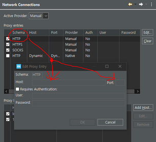

I'm refering to UM1718 file and the link below.
When I set 'Network Connections' in STM32CubeIDE, do I set 'Active Provider' to 'manual', and freely enter Host and Port?
and then, Do I enter them to 'Updater Settings' in STM32CubeMX?

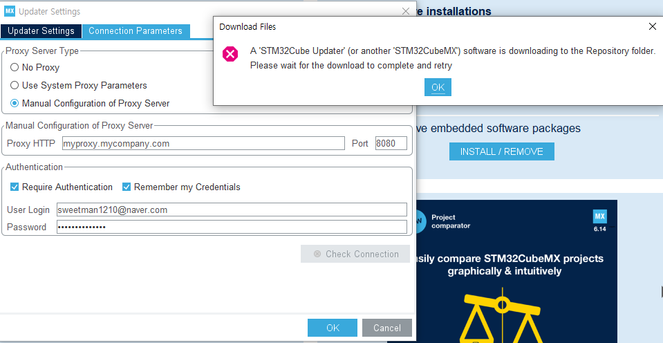

I tried your suggetion with link A, but the error ouccerd again..
What is the cause of the error?
# Link A : https://community.st.com/t5/stm32-mcus/how-to-set-the-network-connection-parameters-for-stm32cubeide/ta-p/585694
# The error
# Left : Network Connections Settings in STM32CubeIDE / Right : Update Settings in STM32CubeMX
