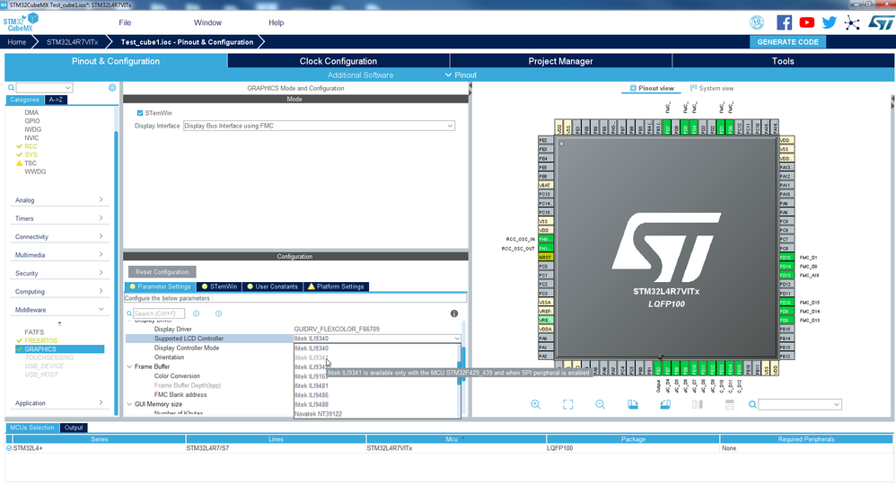

1) Problem with Stemwin graphics. If I choose stm32l4r7vi MCU I cannot use ILI9341 driver of stemwin library, I see message: "ILI9341 is available only with MCU STM32F429_439 and when SPI peripheral enabled"(see attach). But why I cannot use this with stm32l4r7vi via FMC interface?
2) And next bug or feature: If you make "Generate code" and choose EWARM8 and then choose EWARM7 and repeat "Generate code" CubeMX not create correct EWARM7 files (solution: clear folder with project files)
3) Next bug: CubeMX generate for EWARM 7 cmsis_iccarm.h with next define:
#define __RESTRICT __restrict
but right: #define __RESTRICT restrict
4) There is a problem with Stemwin generation for 8 bit MCU 8080 LCD_X_Config(void) contain PortAPI.pfWrite16_A0 (may be after 16 bit to 8 bit switch in CubeMX)
