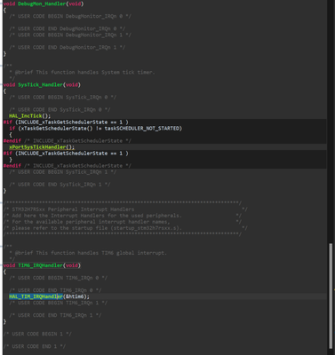

There is a problem with STM32CubeMX 15.0
magicmatrix
stm32h7r/s
in appli context.
Enable FreeRTOS.
Timebase Source is TIM6.
TIM6_IRQHandler is empty.
void TIM6_IRQHandler(void)
/* USER CODE BEGIN TIM6_IRQn 0 */
/* USER CODE END TIM6_IRQn 0 */
/* USER CODE BEGIN TIM6_IRQn 1 */
/* USER CODE END TIM6_IRQn 1 */

This problem doesn't occur every time.
Sometimes in complex projects, such situations may occur.
Sometimes the process of generating code gets stuck.
Next time this problem occurs, I will upload the ioc file.
