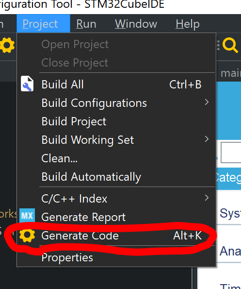

Where I'm stuck: After configuring the device hardware settings in the STM32CubeMX session, I don't see a way to finish the STM32CubeMX session, and no src/ directory is created in STM32CubeIDE's project explorer entry for the new project.
Questions:
  1. What am I missing when interacting with STM32CubeMX when it's launched from STM32CubeIDE as part of creating a new project?
  2. Is there something more to specifying a C++ project at the outset? My inability to solve the error (to the effect) "main()" not found is the root problem I'm seeking to solve.
Thanks for any advice or any requests for clarifying information!

Found the problem - I had overlooked the "convert to C++" (and corresponding "convert to C" options in the project properties.
I believe problem solved at this point.

There should be a "generate code" button or menu option.
I don't think CubeMX can generate a C++ project directly, but you can certainly convert it to C++ after creation. Things may have changed recently.
Edit:
And it appears you can create C++ projects directly now, but it still names the main file "main.c". You can rename it to main.cpp and it will work. I just checked this.

Thanks, TDK - I did find the "Generate code" in STMCube32IDE, but wasn't sure if that was the right way to proceed as STM32CubeMX still seemed to be waiting for user input. I'm accustomed to seeing "GENERATE CODE" on the upper right of STM32CubeMX (when I run it directly, to create a new project for subsequent use in STM32CubeIDE), but that ("GENERATE CODE") button isn't rendered when STM32CubeMX is running as a child of STM32CubeIDE in the path I followed in the first post.
I also just realized I'm using one older version STMCube32MX (6.4.0 vs 6.5.0) at STMCube32IDE (1.8.0 vs 1.9.0). Before I go any further, I'll get the updates done.
