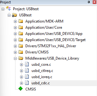

However, after generating the project, several key USB middleware source files are missing, such as:
  • usbd_core.c
  • usbd_ctlreq.c
  • usbd_ioreq.c
  • usbd_cdc.c
  • (and sometimes also usbd_cdc_if.c)

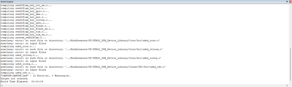

Because of this, the code fails to compile due to missing function references.

It's my 2nd day using STM32, i don't know what to do and here's the screenshootIt's my 2nd day using STM32, i don't know what to do and here's the screenshoot

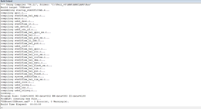

Hello @choirulafiq29 ,
Further to your comment, I reproduced your behavior, and I did not get the compilation errors which you had encountered.
usbd_core.c ; usbd_req.c ; usbd_ioreq.c ; usbd_cdc.c are well generated.
I want to know please the F1 Firmware version.
I will be waiting for your feedback/
Thanks.
Mahmoud

Thanks for your responses, here's the screenshoot of my compiling message error
