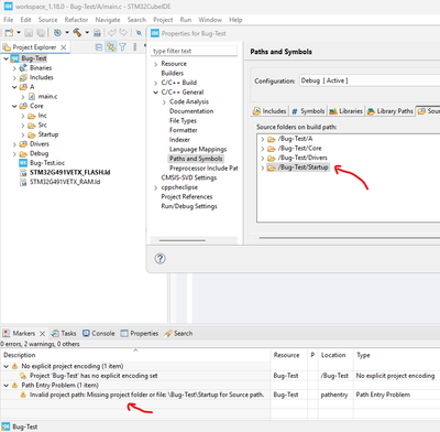

Bug Description:
When regenerating a CubeMX Project with the STM32CubeIDE Toolchain selected, CubeMX will change the ".cproject" file and add a "./Startup/" directory to the source locations of the project if the following conditions are present:
1. In the root directory of the project (where the .ioc file is located) you need to have a directory with a name that is alphabetically closer to 'A' than the "./Core/" Directory. For example "./Application/"
2. In this directory there needs to be a "main.c" file, which would be created by the user.
This will cause CubeIDE to output a warning message on each build, stating that "./Startup/" could not be found.
If the directory name comes after "Core" alphabetically everything is working like expected and no "Startup" directory is added as a source location to the project configuration.

Hello @Heiko_Gericke
I'm currently investigating this , i will get back to you asap.
You mentioned that "This will cause CubeIDE to output a warning message on each build, stating that "./Startup/" could not be found."
Could you please share a screenshot of the  warning message that you are facing.
THX
Ghofrane
Hey Ghofrane,
thanks for the quick response.
Here is a screenshot of the warning in CubeIDE as well as the entry in the project source locations that gets added by CubeMX:
