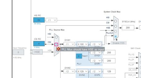

1.) When I select HSI or CSI as clock source, I get error that I have to use HSE as clock even when HSE is disabled??????

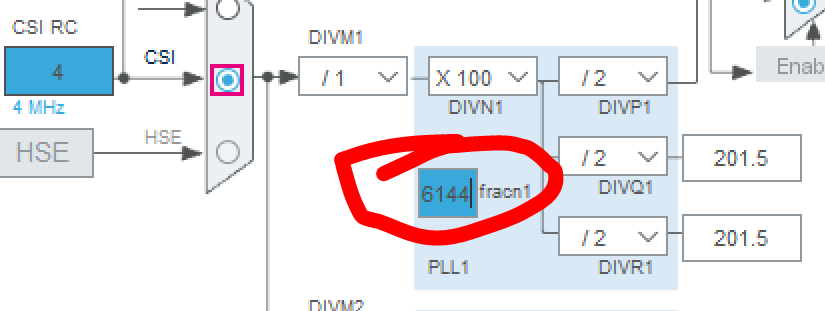

2.) When I select whatever, divide by x to get 4MHz, Multilpy with 100 then devide by 2, I get a sysclk of 201.5. The calculator calculates wrong. Where comes the 1.5MHz extra????
The extra 1.5MHz comes from the fractional value, which is not zero.

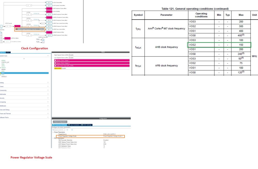

  • In Pinout configuration view > RCC > RCC Configuration Panel > Parameter Settings > Power Parameters > Power Regulator Voltage Scale, the Power Regulator Voltage Scale value is set to 2. Hence, backing to STM32H753xI Data Sheet DS12117 Rev 7 the AHB maximum clock frequency fHCLK should not exceed the 150MHz:
  • When selecting CSI as the PLL source , an error message is displayed: "PLL Mux should have HSE as input". In fact this error is due to activation of USB_OTG_FS.
Backing to same Data Sheet mentioned above > 3.41 Universal serial bus on-the-go high-speed (OTG_HS):
"USB OTG controllers require a dedicated 48 MHz clock that is generated by a PLL connected to the HSE oscillator".
  • Concerning the clock frequency calculation (when fracnx is set to value other than 0) , please refer RM0433 to "RCC PLLx Fractional Divider Register".
I've tried to do some changes in your attached .ioc in order to resolve manually the clock issues:
- I've set the franc1, franc3 to 0.
- I've set the VOS to 1 to match the fHCLK =200MHz.
- I've changed the PLL Source Mux to HSE (after selecting Crystal/Ceramic Resonator for HSE) and set HPRE set to /2, DIVQ1 to /4 and DIVQ3 to /5 accordingly.

Moreover, in the subject of of the "PLL Mux should have HSE as input" error, selecting RC48 as an USB clock source can also clear this error.
In fact, for USB application, the internal clock source is not precise enough: To achieve a High-Speed communication, a high frequency clock is required. So the USB clock is sourced from the HSE clock.
Thus, if you're using USB in your project, it is preferred to use HSE clock source for best accuracy since RC48 clock does not technically guarantee the clock stability required for USB use.
RC48 can be good enough, hence it can be used as USB Clock source.
Khouloud.

I know, there are missconfiguration in this file because the problem happened middle of design phase but explain me please why I have to use External crystal for my clock? There is not external crystal. Why I can neither use CSI nor HSI??? The clock source was a missconfiguration which I changed back.
Please also see what happens when you change for example to CSI. The blinkung of almost everthing hints to understand the reason and during this time you can only wait. You cant do anything because the blinking blocks all comboboxes so that you cant change the in the right way. A messagebox would help a lot more. But anyway, I never changed the Power Regukator Voltage Scale. Why its wrong? Who/what change that to the wrong value.
My main problem is that I dont have an external crystal and I cant use this configuration at all.
An HSE is required to satisfy the timing requirements of USB in OTG mode. The CSI/HSI is not accurate enough.
