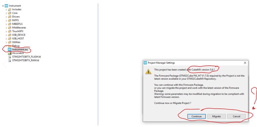

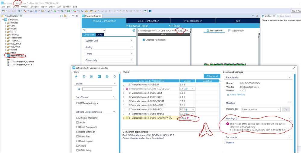

@AWies.1 good and bad news ... I'm able to reproduce and confirm your issue.
Based on your .ioc file if 1.3.1 project is generated fine.
Moving then to 1.4.0 and asking for project update from device configuration tool is performing almost full project removal :o :sad_but_relieved_face:
Not mastering such enough but sounds related to the fact your're using TouchGFX pack. Device configuration tool is claiming 4.13 is not supported. have to migrate to 4.14 ....
I've not tried but maybe taking care of some migration option is doing proper job ? @Martin KJELDSEN @Alexandre RENOUX @Romain DIELEMAN TouchGFX experts please help here !

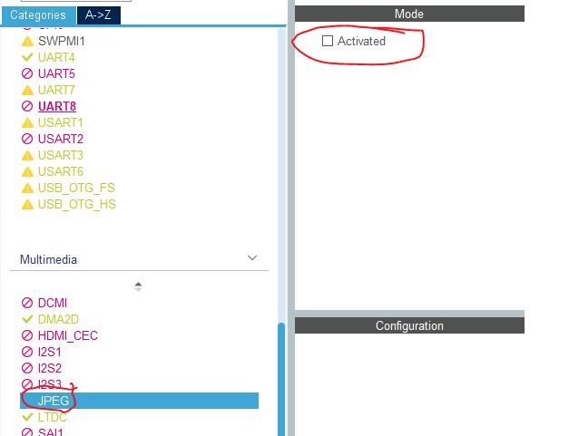

Ok. Have you within your original project some 'Utilities' folder prior asking to update ?
2020-07-29 11:13 AM
Let's try to disable JPEG multimedia and you are saving your project.
I agree such is not a solution anyway ...
Doing such is disabling 'Utilities' folder usage which sounds be root issue source

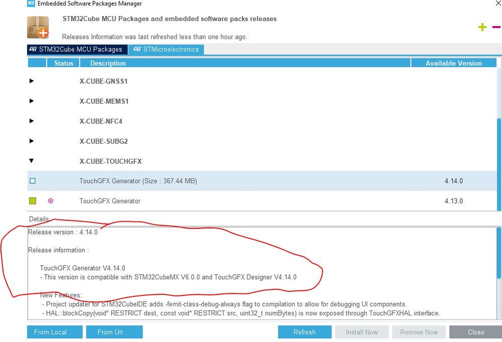

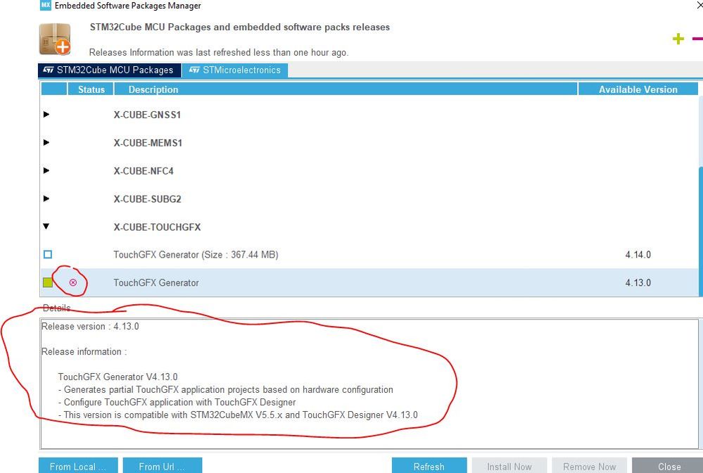

I manage to reproduce the issue. I don't know why it happened but what works is the following.
Use CubeMX and CubeIDE separately.
- Open the .ioc file with CubeMX 6.0.0 and migrate the project
- At that moment, the TouchGFX Generator is not updated, and you are using the old 4.13 version that is not compatible with CubeMX 6.0.0. If you generate at that moment, you will not have your project deleted, but you will probably have some compiling error afterwards.
- So before generating, as shown by @Cartu38 OpenDev in the previous message, update to version 4.14.
- Then generate code with CubeMX
