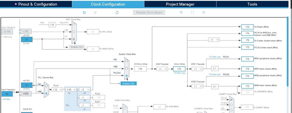

Working on interfacing Nucleo-G491RE to EVAL-AD5592R-PMDZ evaluation board using SPI interface (SPI2). Before jumping on to it I just probed SPI2_SCK and made the necessary configurations to it using STM32CubeIDE and generated code. Using HAL_SPI_TransmitReceive sent bytes to be able to capture the SPI2_SCK on PB13 but did not get the expected clock on the oscilloscope. What did I miss out on configuring SPI?
Please find the screenshot of the SPI configuration on STM32CubeIDE in the attachment.

How did the SPI2 get the clock to operate in Clock Configuration?
‎2023-04-10 7:44 AM - edited ‎2023-11-20 8:58 AM
Set the HCLK 1to 170 MHz. Use the Cube Clock configuration tool.
As below. (note: this config is likely not optimal, only as example)
Then the SPI baudrate will be as on your screenshot.

‎2023-04-11 12:02 AM
Hi, thanks for your input. It seemed to be a bug from the IDE. If I flash directly using the default Clock Configuration it does not work for me. Changing the clock to some other value, say 100 MHz from 170 MHz and generating code then again changing back to 170MHz, allowed me to view SPI2_CLK and SPI2_MOSI. But still not able to view the SPI2_NSS line.
