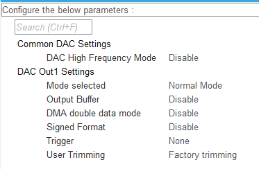

The first case concerns the DAC, by setting "Output Buffer" = Disable in CubeMX, it is enabled in code generation instead, i had to add "DAC1->MCR = 0x03" in the initializations.
 * @brief DAC1 Initialization Function
 * @PAram None
 * @retval None
static void MX_DAC1_Init(void)
 /* USER CODE BEGIN DAC1_Init 0 */
 /* USER CODE END DAC1_Init 0 */
 LL_DAC_InitTypeDef DAC_InitStruct = {0};
 /* Peripheral clock enable */
 LL_APB1_GRP1_EnableClock(LL_APB1_GRP1_PERIPH_DAC1);
 /* USER CODE BEGIN DAC1_Init 1 */
 /* USER CODE END DAC1_Init 1 */
 /** DAC channel OUT1 config
 DAC_InitStruct.TriggerSource = LL_DAC_TRIG_SOFTWARE;
 DAC_InitStruct.WaveAutoGeneration = LL_DAC_WAVE_AUTO_GENERATION_NONE;
 DAC_InitStruct.OutputConnection = LL_DAC_OUTPUT_CONNECT_INTERNAL;
 DAC_InitStruct.OutputMode = LL_DAC_OUTPUT_MODE_NORMAL;
 LL_DAC_Init(DAC1, LL_DAC_CHANNEL_1, &DAC_InitStruct);
 LL_DAC_DisableTrigger(DAC1, LL_DAC_CHANNEL_1);
 /* USER CODE BEGIN DAC1_Init 2 */
 /* USER CODE END DAC1_Init 2 */

Hello @cb.7 ,
Thank you for bringing these issues to our attention.
Related to the first problem (DAC Peripheral), an internal ticket is raised to the dedicated team
( Ticket Number : 214226 ).

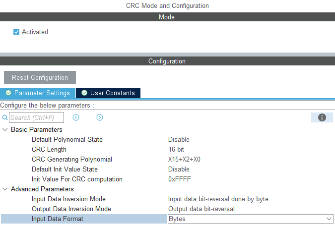

a third case came up:
static void MX_CRC_Init(void)
 /* USER CODE BEGIN CRC_Init 0 */
 /* USER CODE END CRC_Init 0 */
 LL_AHB1_GRP1_EnableClock(LL_AHB1_GRP1_PERIPH_CRC);
 /* USER CODE BEGIN CRC_Init 1 */
 /* USER CODE END CRC_Init 1 */
 LL_CRC_SetInputDataReverseMode(CRC, CRC_INPUTDATA_INVERSION_BIT_BYBYTE);
 LL_CRC_SetOutputDataReverseMode(CRC, CRC_OUTPUTDATA_INVERSION_BIT);
 LL_CRC_SetInitialData(CRC, 0xFFFF);
 LL_CRC_SetPolynomialCoef(CRC, 32773);
 LL_CRC_SetPolynomialSize(CRC, LL_CRC_POLYLENGTH_16B);
 /* USER CODE BEGIN CRC_Init 2 */
 /* USER CODE END CRC_Init 2 */
workaround added in main.c
#define CRC_INPUTDATA_INVERSION_BIT_BYBYTE LL_CRC_INDATA_REVERSE_BIT_BYBYTE
#define CRC_OUTPUTDATA_INVERSION_BIT LL_CRC_OUTDATA_REVERSE_BIT

Hello @SPozz.1
Let me thank you for posting and bringing this issue to our attention.
It has been escalated to the relevant team for fixing (Internal ticket number: 214506 Internal ticket number is only for reference, not accessible or usable outside of ST).
