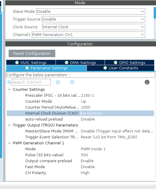

I'm trying to control a Servo motor (MG90S) using the STM32F767Zi by leveraging the TIM2 Channel 1 (PA0).
The Servo requires a 50Hz frequency (20ms) signal.
The APB1 bus gives TIM2 timer port 108MHz frequency.
The Servo is powered through a 5V port through STM and STM is powered through USB type B cable from my laptop.
I'm using the below calculations for PSC and ARR and have given a Duty Cycle of 2.5% - 12.5%. (0.5ms - 2.5ms)
My Timer_freq TIM2(APB1) is 108MHZ(108000000)
Required Frequency is 50Hz
i.e PSC*ARR = 108000000/50 == 2160000
PSC = 2160-1
ARR = 1000
Duty Cycle given is: (since ARR = 1000 i.e 100%)
TIM2->CCR1 = 25 (0 degrees - 2.5%)
TIM2->CCR1 = 125 (180 degrees - 12.5%)

I'd divide down to 1 MHz (PSC of 108-1), giving a tick rate of 1us, and ARR of 20000-1 for 20 ms
Then CCRx would be in us, 1500 would be top-center (1.5ms)
The F7 chip doesn't have a 5V pin, the "signal" would be 3.3V CMOS levels, but should be sufficient. Validate signal with a scope.
