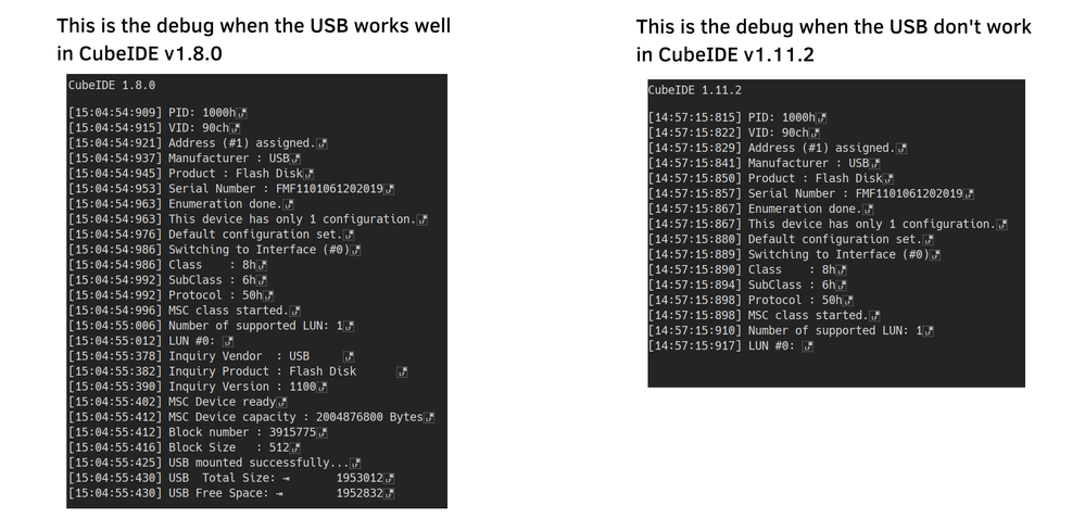

I have a very simple code and it is works wery well in Cubeide V1.8.0 and the same code does not work at all in Cubeide v1.11.2.

The reason: function "USBH_USERPROCESS" never gets state
"Case host_user_class_active:
  Appli_state = Application_Rready;
If you insert a USB flash drive, it gets state
  case HOST_USER_CONNECTION:
  Appli_state = APPLICATION_START;
  break;
If you take out the USB flash drive, it gets state
CASE HOST_USER_DISCONNECTION:
  Appli_state = Application_disConnect;
  Break;
But, as I wrote above, the function "USBH_USERPROCESS" never gets gets state
Appli_state = Application_Rriedy;
Break;
Could someone tell me what was changed and how to fix it?

I turned on the debag for the USB to compare in the working version in CubeIDE v1.8.0 with a non -working CubeIDE v1.11.2
Could someone tell me how to fix initialisation of USB?
And below comparison
