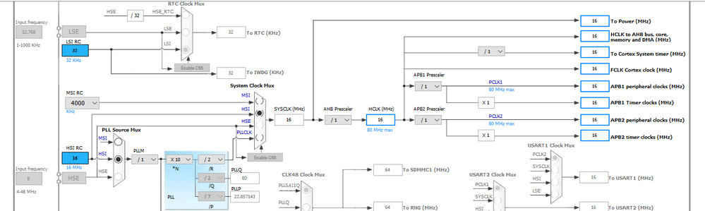

I am using MDK5 (5.22) with STM32CubeMX (4.26.1). I generate blank project within CubeMX for STM32L471ZGTx (144pin MCU). Clock configuration uses internal HSI and LSI and it's set to 16MHz. For testing purposes I configured clocks so all other clocks are 16MHz (SYSCLK, APB1, Timers, Cortex etc...)

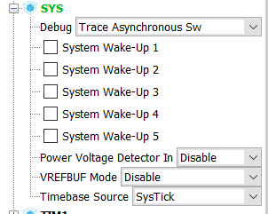

Under SYS menu I enable TRACE asynchronous SW to use SW for programming and SWO for retargeting printf.

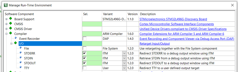

I generate project and open it in MDK5 then under RTE editor I set up Compiler->I/O and select all options to ITM. So retargeting of printf goes to ITM.

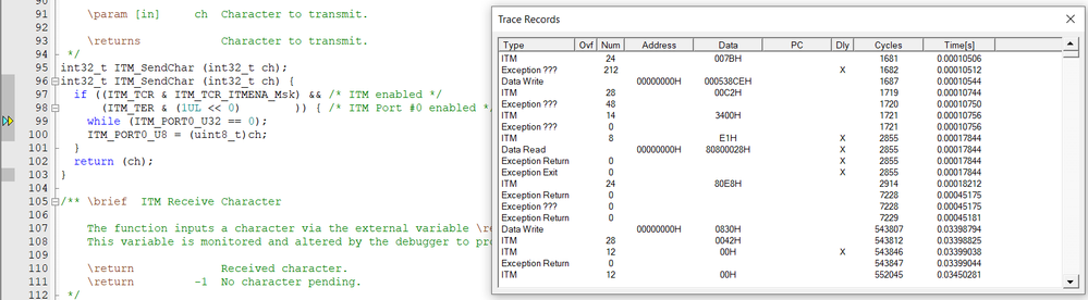

But I get stuck on that command. If I press Stop code execution it points to file retarget_io.c to line 99. Obviously I am stuck within that while-loop:

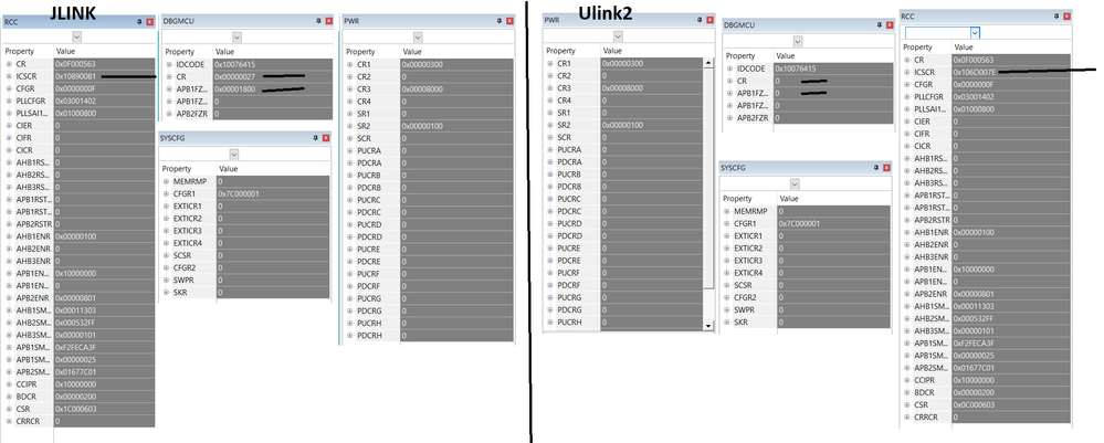

Additionaly I found out that if I try to debug first with J-link then I switch to ulink2 printf starts working with ulink (until next hardware reset). I guess that J-link puts MCU's registers in different startup states comparing to Ulink2. So what I did I made screen capture of registers when using JLink and registers when using Ulink2... and I found differences in DBGMCU registers. Then I forced those register values to same as with JLink and printf works. (see attached image for differences)
I think I will make a configuration ini file for debug mode which will setup those registers on startup when using Ulink2.
