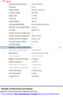

I'm new to STM32CubeIDE and currently working with the STM32H723Zx in the LQFP144 package. While configuring the SAI1 peripheral, I encountered something that seems counterintuitive.

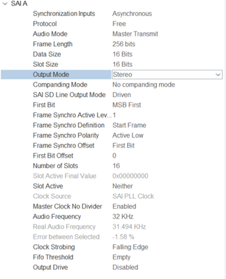

When I set the output mode to Mono, the "Number of Channels" option only allows 2 channels to be selected. However, when I switch the output mode to Stereo, I can select up to 16 channels.
This behavior seems reversed to me—shouldn't mono mode allow more flexible channel selection, or at least fewer limitations than stereo?
I've attached a screenshot below for reference.

Hello @Kewin_J
In the STM32H7, SAI peripheral, mono mode always uses 2 channels because the hardware sends audio data in pairs of channels (called slots), even if you only want one audio signal. So, mono audio is duplicated or placed in one of these two channels. On the other hand, stereo mode supports multiple pairs of channels, allowing you to select up to 16 channels for multi-channel audio. This design is due to how the hardware processes audio data, not a software limitation, which is why mono mode is limited to 2 channels while stereo mode allows many more.
More details could be found in  RM0468: 56.4.13 Specific features
THX
Ghofrane
