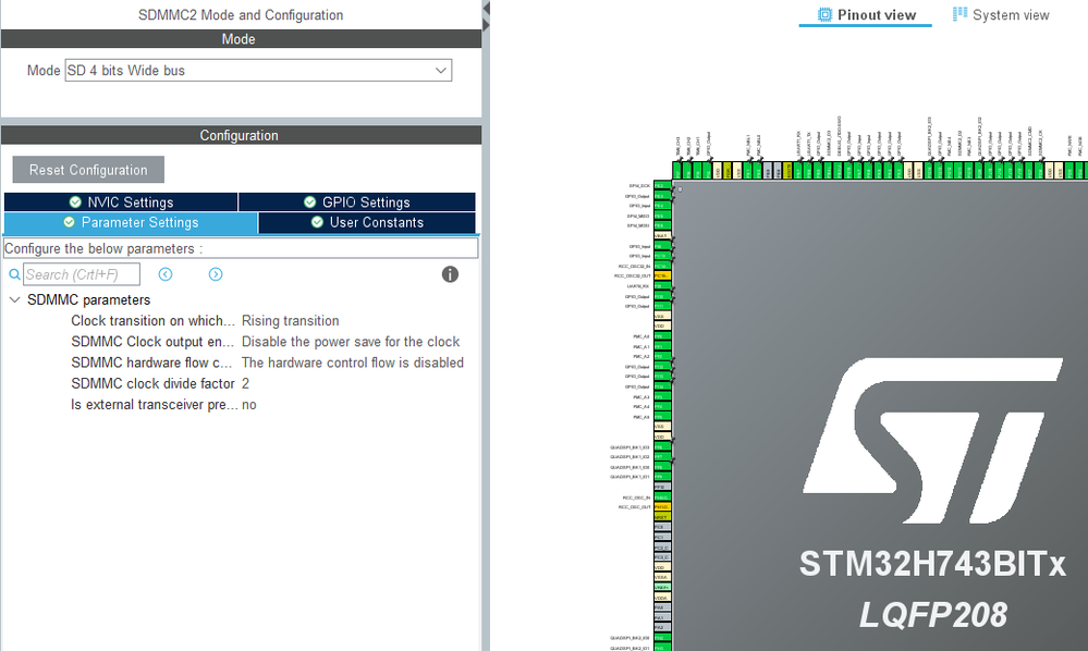

I have a custom board with an STM32H7. I configured SDMMC2 correctly on it.
As you can see there is no options for configuring DMA since it has an Internal (I)DMA.

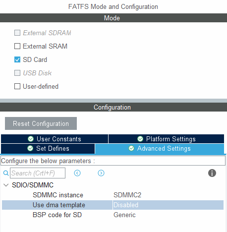

I have also added FATFS, as follows.
I managed to write/ready successfully to SD CARD mounted via FATFS. My problem arises when I enable the ‘Use DMA Template’. It is a must in order to later add FreeRTOS to the project.

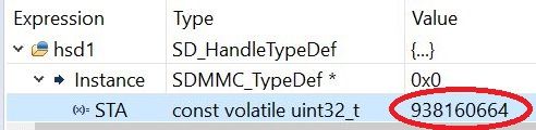

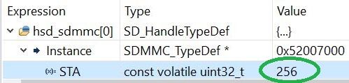

- That change is because I found hsd1 is incorrect (Instance->STA = 938160664 // SDMMC_FLAG_RXOVERR), while hsd_sdmmc[0] indicates the correct one (Instance->STA = 256 // SDMMC_FLAG_DATAEND).
