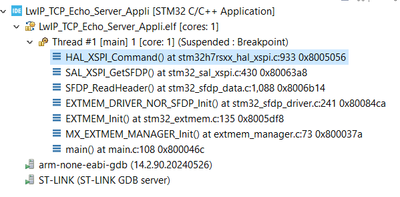

My problem:
When I run the code in debugger mode, execution never gets out of Template_XIP_Boot.
Ends up in error handler.
void Error_Handler(void)
__disable_irq();
while(1)
Call stack:
HAL_XSPI_Command returns with status=HAL_BUSY
I'm sure I'm missing something but can't afford weeks to find it. Any help or insight would be appreciated.

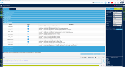

Hello @JimEno ,
It is mentioned on the Readme file to enable high-speed option byte with STM32CubeProgrammer Tool.
XSPI2_HSLV=1
Thanks.

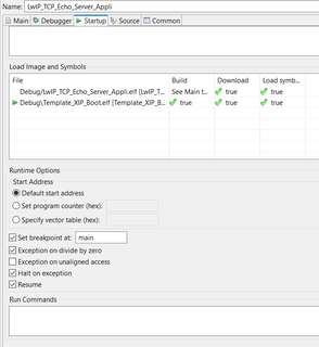

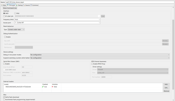

For more investigation, I suggest please that you provide the Debugger and the Startup configuration.
Thanks.
Mahmoud
JimEno
Recommended info added. Tried to follow README.md file as best as I could.

I was using the IDE to build and program the sample project. I assumed the IDE or MX would handle any settings or options. I did not assume I HAD to use the Programmer to set any options. I will try this and report back.
Thanks for your response Mahmoud.
JimEno
Mahmoud,
I enabled that option byte as you suggested. It worked.
- User Option Bytes requirement (with STM32CubeProgrammer tool)
- XSPI2_HSLV=1 I/O XSPIM_P2 High speed option enabled
It seems like setting this option could have been done in the sample project
firmware. I shouldn't need the Programmer. Am I wrong?
I will consider this issue resolved. Thanks for your response.
