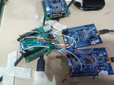

Hello! I had the similar problem. My app (there is not any  FreeRTOS ) works well in 1-bit mode, but in -bit mode not working at all (to be honest - sometimes with very old 1Gb SD card). The wires from SD card to STM32 have  length roughly 50 millimeters. I tried a chunk of  old interface cable from old HDD, but I have not success. Finally I got several simple wires and connect 50Ohm resistors next to the SDIO Card slot in series with each wire (exclude Vss and GND). The interface started works well in 4-bi mode.
