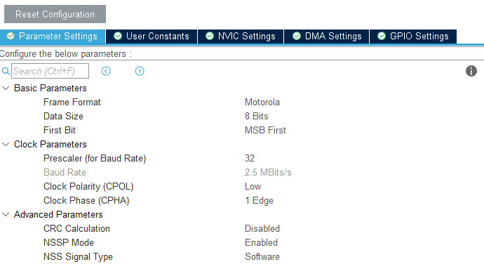

Hello Guys,
Last week I tried to add an SDCard Module on my STM32L476 project and i followed this tutorial: embetronicx.com/tutorials/microcontrollers/stm32/stm32-sd-card-interfacing-with-example/
I can't read the SD in fact I get back FR_NOT_READY when I execute the f_mount method.
Please Note that: The project already contains FREERTOS and it used TIM1 as a timebase source for SYS as it was recommanded so i had to add my timers function in the timer interruption call back like this:

This is the setup i am using on cubeMX:
I used similar tutorials with the same steps in previous CubeIDE versions and on SWB4ST32 and it worked fine

Hello @Community member​,
Could you provide more details about CubeIDE version working/not working also, CubeMX and the Cube firmware package?
You may use some external 5V power source. It is possible that the current required for the module is not sufficient.

@Community member​, Make sure that the baudrate in the SPI config is respected and make sure the chip select is connected. Any feedback would be appreciated.

Attached the configuration.

Hello F.Belaid,
Thanks for your reply,
I tried your proposed solution sadly it didn't work.
It would be appreciated if you uend me the project you tested on the SDCard
Please Note that i'am using CubeIDE V1.10.1, CubeMX 6.6.1 and Firmware Package L4 V1.17.2
Thanks in advance

HNefz.1
Hello @F.Belaid​ ,
thanks for the reply and i am sorry for the late response
i tried running the project you sent me today and it works
however after regenrating the project using cubeIDE's cubeMX the project now displays a new behavor:
the system harfault directly pass the fmount function .
even trying to enter the function using F5(step into) option leads to hardfault
and the hardfault is said to be caused by a <signal handler called>() at 0xfffffffd
keep in mind that this was tested on cubeIDE 1.12.0 with cubeMX 6.8.0 and FW package 1.17.2 and cubeIDE 1.11.0 with cubeMX 6.7.0 and FW package 1.17.2 with the same results
please note that i tried a version of the code without freertos based on the tutorial mentionned above on cubeide 1.12 and it runned with no hardfault
i included a copy of the project on cube IDE 1.11 below
