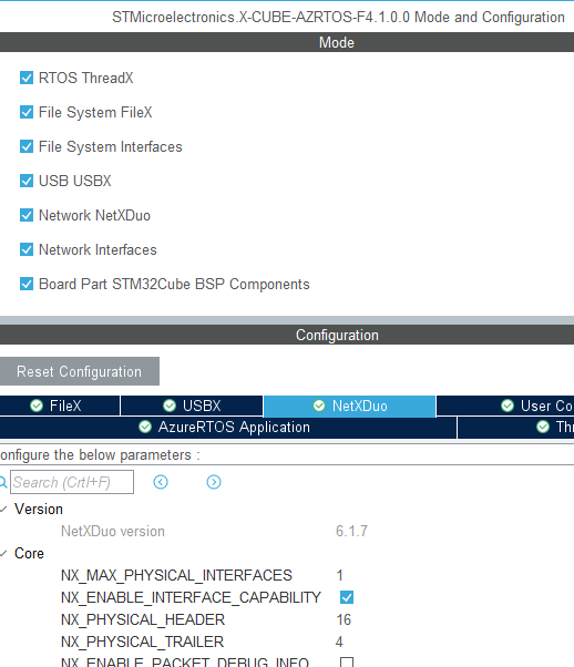

To try Azure RTOS for my new project with the same board, I have installed STM32Cube 6.4 and the necessary libraries for the STM32F4xx processor. So far, all the porting works when using ThreadX, FileX, and UsbX.
When trying to enable the ethernet (NetX) for MII mode, I encountered a problem in that the DHCP client was unable to obtain an IP address from my router. I search through all the NX (NetX) examples from STM32Cube 6.4 and 6.5 but was unable to find one that uses MII mode. In this design, we are using DP83848 PHY chip.

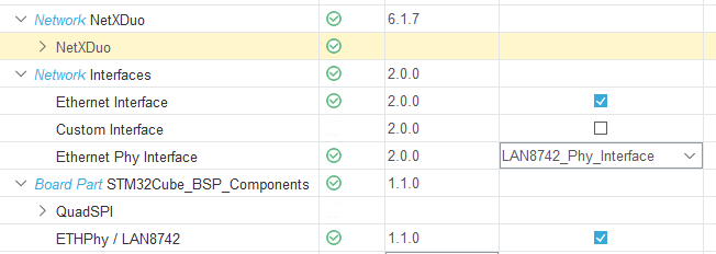

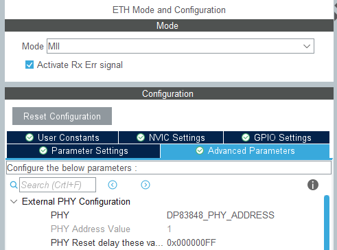

When selecting MII mode in "ETH Mode and Configuration" window, it displays "DP83848_PHY_ADDRESS". under PHY option. But in the "Network Interface->Ethernet Phy Interface" under "Software Pack Component Selector" window, there is no option to select DP83848. The only chip available is LAN8742A. I don't know if anyone encounter the same problem and already has a solution. Will appreciate all the help.
