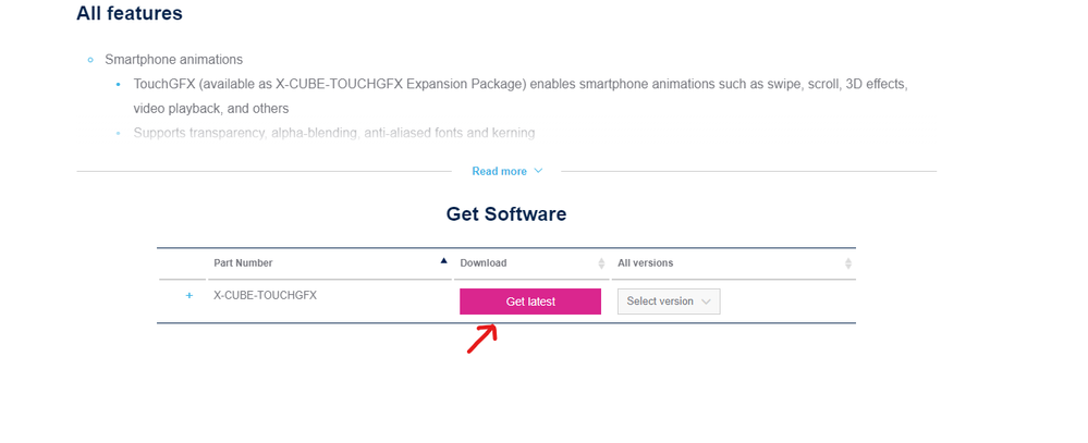

1- Navigate to this link: X-CUBE-TOUCHGFX - TouchGFX advanced and free of charge graphical framework optimized for STM32 microcontrollers - STMicroelectronics
2- At the bottom, click on download the latest version :

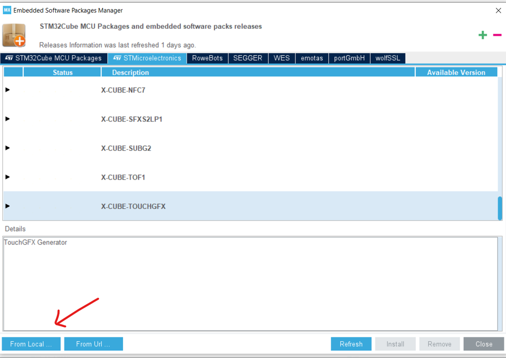

3- Open STM32CubeMX > Help > Manage embedded software package

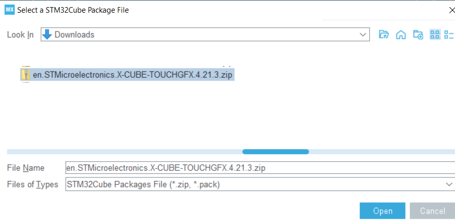

4- Click on "From Local" and select the zip file dowloaded at step 1.
5- Accept usage license (popup during installation)

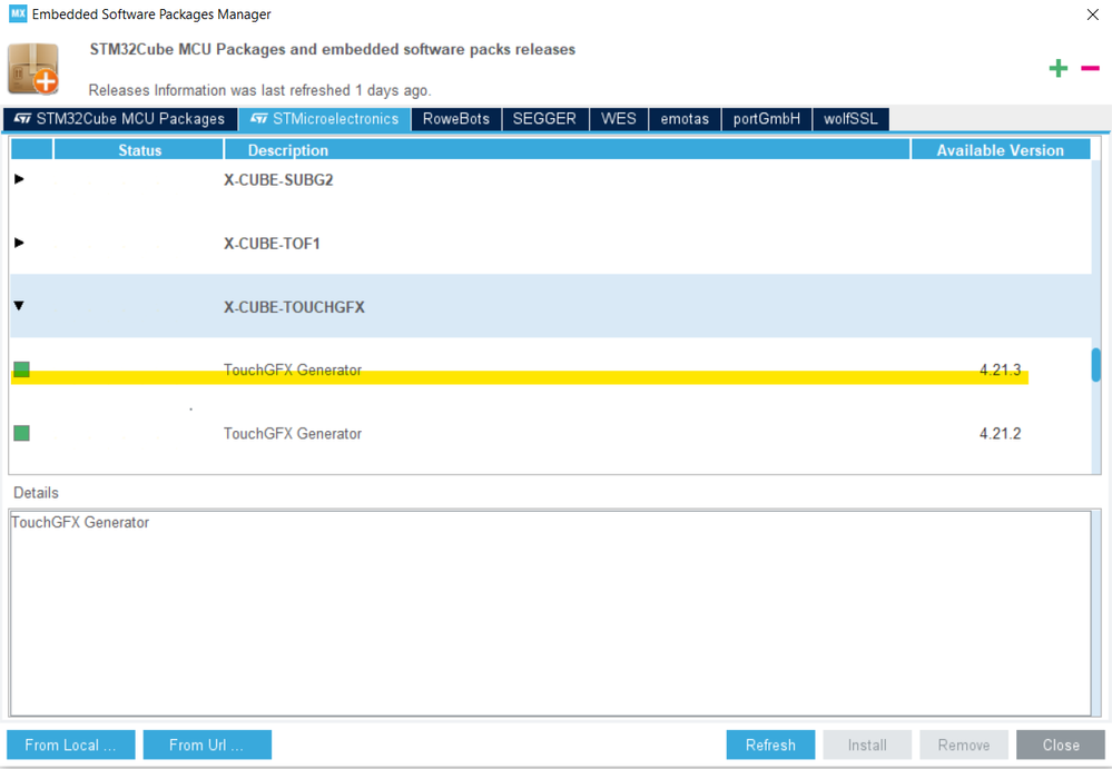

6- Check if the X-CUBE-TOUCHGFX 4.21.3 is installed

The "Migrate" message is something we're currently working on; we are updating all our TBSs and Demos with STM32CubeMX6.8 so you won't get this message in future. Concerning the warning about unknown X-CUBE-TOUCHGFX.4.21.3, I invite you to follow the steps described by @Romain DIELEMAN​ in this thread.

‎2023-03-24 3:41 AM
Hi Oskt,
step 4, to call TouchGFX.zip by clicking the "From Local ..." button is important. I have done it directly by clicking the zip-file in the download area. That does not work!
Many thanks
