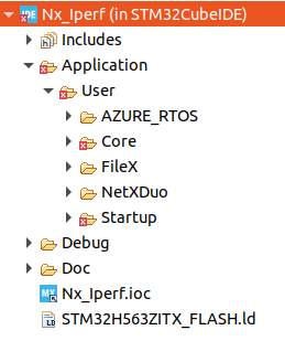

As a result the project outline changed and the project did not build anymore due to lots of undefined references by the linker (SystemInit(), _tx_timer_interrupt(), many HAL_* functions).

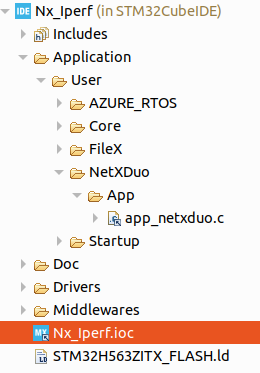

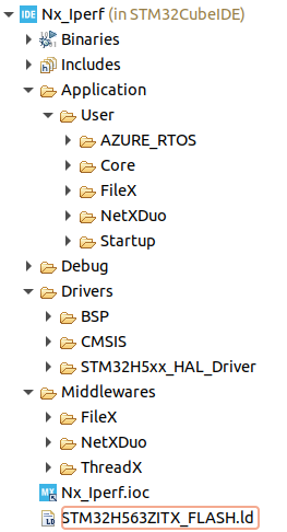

Original project structure:
Structure after code has been regenerated:

‎2023-03-22 12:04 PM
New structure:

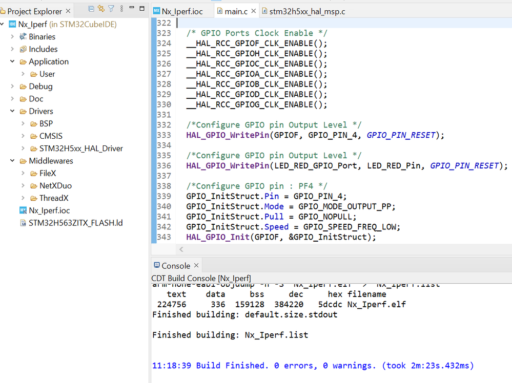

‎2023-03-23 3:26 AM
Hello @Community member​ ,
After modification (add PF4 as GPIO output) , go to project manager -> Code generator :
Re-generate the code:
Hope I helped you!
Foued

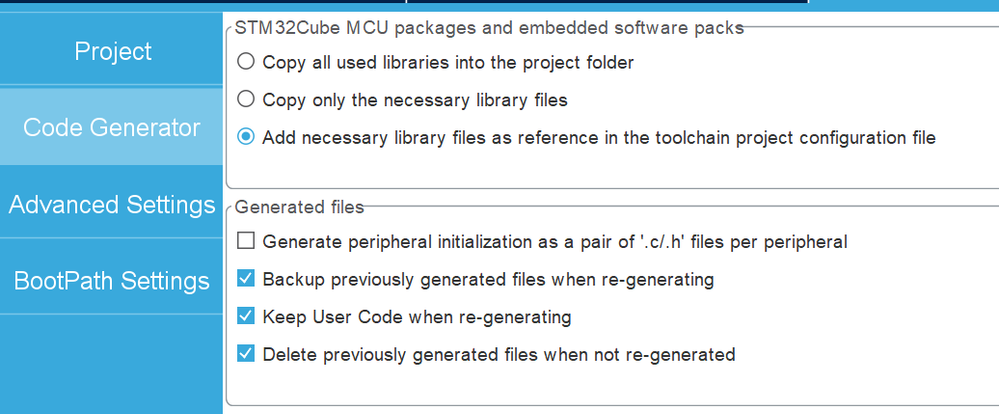

‎2023-03-24 4:04 AM
Could you try please to enable the " Backup previously generated files when re-generating "
Foued
‎2023-03-24 8:47 AM
This option was already switched on.
