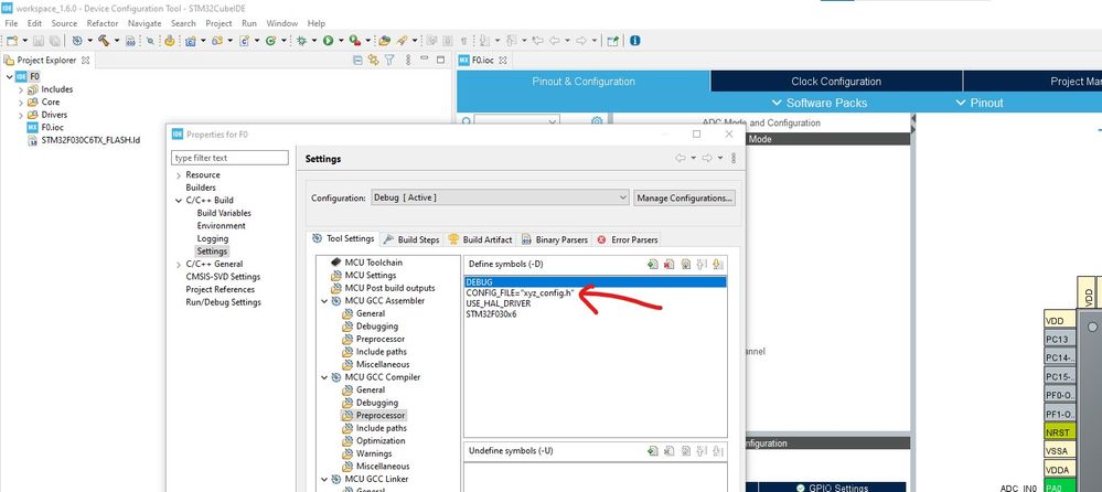

I'm working with CubeMX 6.2 & CubeIDE 1.6.0.
I have several problems with the generated code that I would like to know if I can somehow resolve instead of changing the generated code every time after changing something in the CubeMX project.
This is the list:
  • I have a defined symbol under the CubeIDE GCC Compiler preprocessor settings, for example CONFIG_FILE="xyz_config.h". This setting is override by CubeMX
  • When I use ETH with my H743 based project the CubeMX add to main.c a definition of DMA descriptors. I have those descriptors defined somewhere else in the code based on my application specific needs. Is there a way to make CubeMX not to generate this part in main?

Myself if 1.6.0 I've no issue to keep my sybol definition despite asking for new code generation (because IP setup update or ...)

Hi @egoltzman​ ,
Maybe you have to put ETH initialization with the other code and just disable ETH from Mx.
I don't think it is possible to disable DMA descriptors generation since I tried this in Mx and could not.
I will verify this with Mx team and provide you with the exact information.
