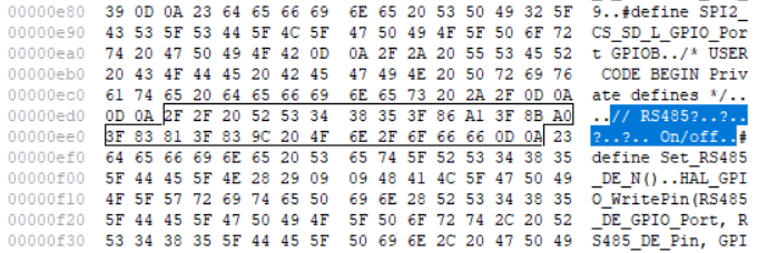

I processed "Generate Code" in the MX.
It changed the code of Korean comments.
I used the comment //.
Please don't change the characters between // ~~~~ 0x0D.
This is normal status.
After code generation it changed to:
After that, I cannot read Korean.
I would like a quick fix.
Thank you.​

I have same problem. Is it fixed?
