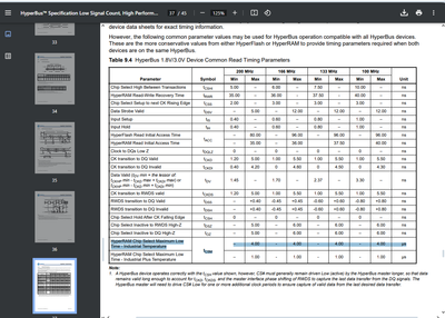

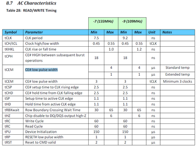

About the refresh rate. My octospi clock is 104Mhz, i use as external ram memory APMemory APS6408L-3OBMx, could someone help me calculate the refresh rate?
I have found the answer to my question myself.
1/104MHZ = 9.62ns = octospi clock cycle
Refresh = Refresh rate/ octospi clock cycle   = 4µs/9.62ns = 4µs/(1/(104MHZ)) = 416
Choose as refresh value 417 or 418, don't ask me why.
The value of refresh rate, we can find it in datasheet, for APMemory it is the parameter tCEM(CE# low pulse width), for my memory it has the value 4µs. --> See picture below.
Refresh rate for the Hyperbus Cypress memory(infineon): look at the parameter "HyperRAM Chip Select Maximum Low Time - Industrial Temperature" = tCSM = 4.00 µs --> see picture below
