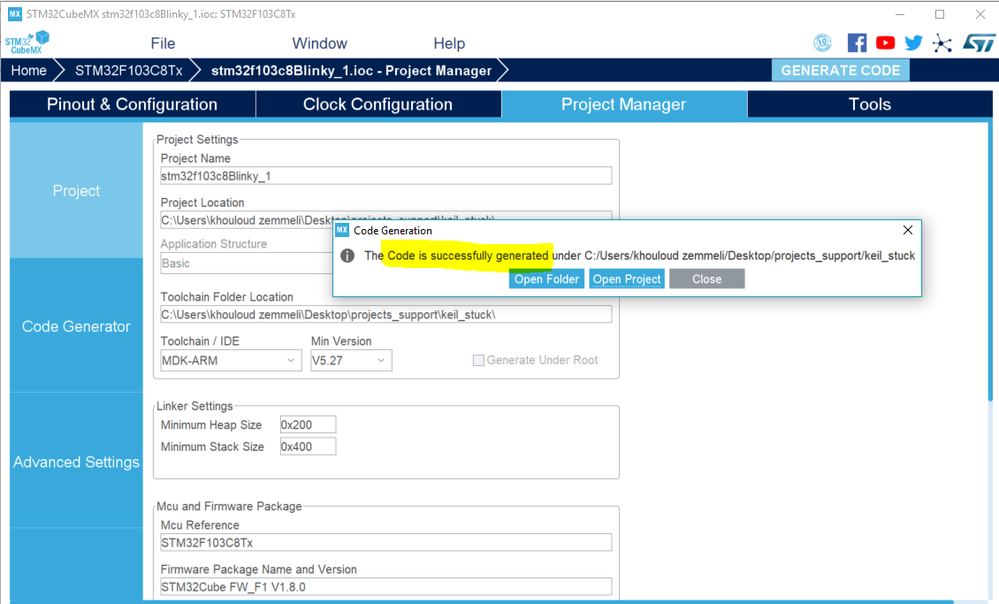

Khouloud ZEMMELI
November 1, 2019
​It works fine for me :
