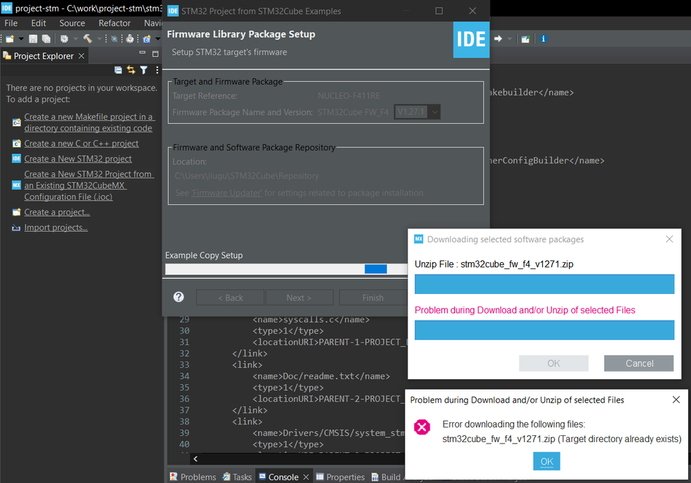

Hello, when I tried to create an stm32 project, at the last step of generating the code, I came across this warning and the code was not generated.
0693W00000Sv770QAB.pngAfter it tried to unzip stm32cube package, it says "Target directory already exists". I did already download and unzip the package. But it seems not using that folder and files. Do I have to remove the one I unzipped and then creating the project?

An update:
I deleted the existed directory and then it automatically downloaded and installed the software package. Then it worked.

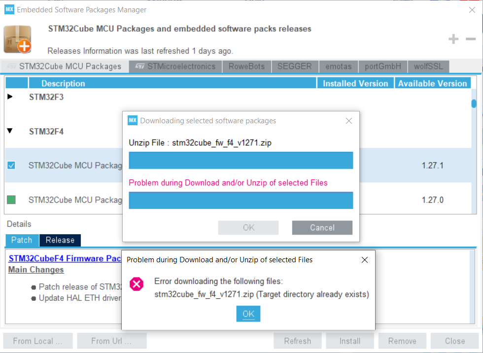

Thank you @ChahinezC​ for your reply.
The package is already installed. The notification says "target directory already exists."
This is the screenshot when trying to install the package.

Hi @Crane​,
In the screenshot you attached, the package installed is the STM32F4_Cube_FW V1.27.0 not the V1.27.1 required.

Crane
I tried to install the latest version, but got the same warning. I already moved the current version to another folder.0693W00000SvWVlQAN.pngI am wondering why it must require the latest version. And the latest version is only a patch to the last version.
