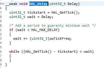

I would like to know how can I make the HAL_Delay function work. I configure the System CLock with CubeMX, when I compile the prog there is no errors but my program loops in the HAL_Delay function.

Check the operation of SysTick_Handler() using the debugger. Make sure it fires correctly. If not - check what you did wrong (disabled all interrupts, misconfigured SysTick).

Well if I had to guess, you're probably calling HAL_Delay from an interrupt, which will not work.

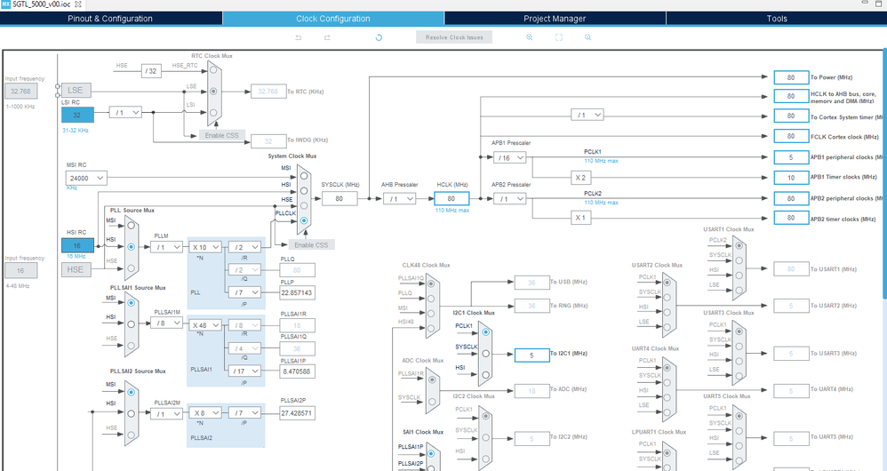

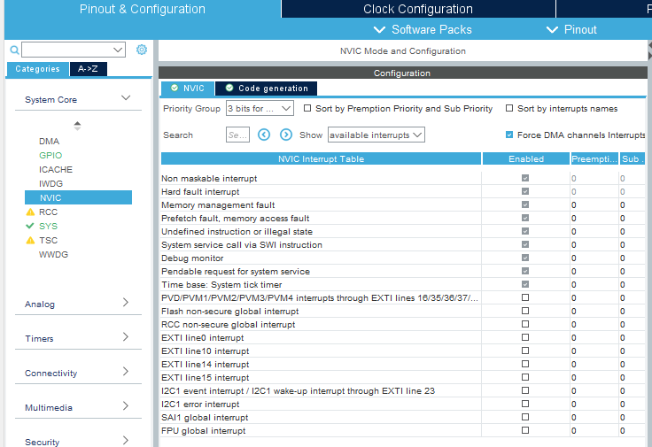

I don't know if I use with interrupt this function HAL_Delay but It's the summary of my configuration

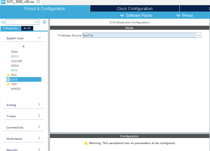

0693W00000Y7YzIQAV.pngOn the other hand, I can see the SysTick of my configuration is not configured
0693W00000Y7Z01QAF.pngyet my Clock is configured, I probably missed a step. Do you know if I can find information how to activate SysTick ?
0693W00000Y7Z0aQAF.pngI think when you configure when you configure the Clock the SysTic is automatically configured.
Thank you for your advices
Regards

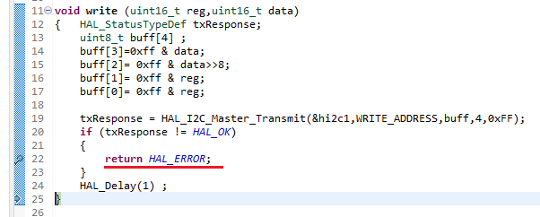

After some changes, now I think my I2C does not work correctly. In this prototype :
0693W00000Y7aFqQAJ.pngThe HAL_I2C_Master_Transmit return an error, probably for the same reasons. Do you know where I can find examples with I2C ?
Thank you for your helps.
Regards

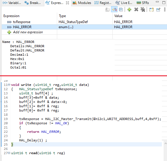

It could mean that the I2C slave address is invalid or a physical connection issue. You should see what the txResponse value is. Is that where the HAL_Delay is stuck? And why is a 1ms delay needed in that write function?
Also, your write function is a void and you are trying to return HAL_ERROR. The compiler should have gave you a warning about that..

Thank you, yes I have a number of error is 1, but what does that mean ? I don't know.
0693W00000Y7aXfQAJ.pngYes I have a warning but I don't know how to return a value. For the hardware (wiring and component address, all is correct). I think it comes from the Clock or SysTick. In fact the I2C need theses parameters.

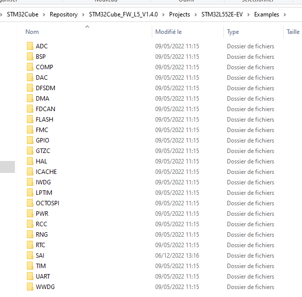

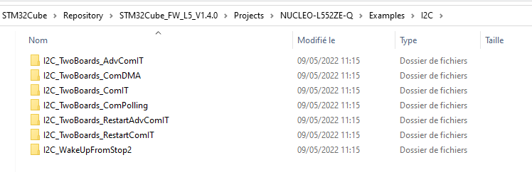

After browsing the directory I couldn't find the I2C example with my evaluation board.
0693W00000Y7b7TQAR.pngProbably I have to look elsewhere.
Karl Yamashita
Principal
You can use the Nucleo example. It is the same Microcontroller.
C:\Users\<suer name>\STM32Cube\Repository\STM32Cube_FW_L5_V1.5.0\Projects\NUCLEO-L552ZE-Q\Examples\I2C
Also, i'm not sure what I2C device you're trying to write to but if it's a 16 bit register then you're not writing the value to your buff array correctly.

I can see sevaral example but I don't know which file corresponds to my evaluation card ?
0693W00000Y7gRsQAJ.pngProbably I2C_TwoBoards_ComPolling may suit my needs ?
