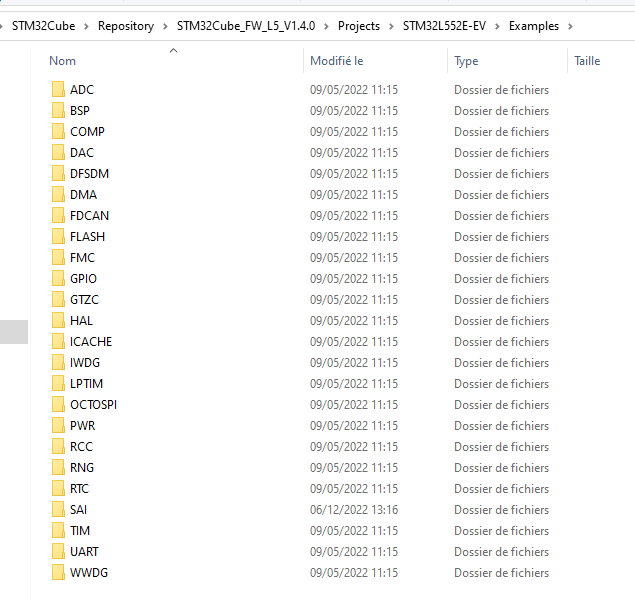

DYann.1
DYann.1Author
Senior II
January 9, 2023
Hi Parvel,
No my board is 'STM32L552E-EV' but there is no example with this evaluation Board.

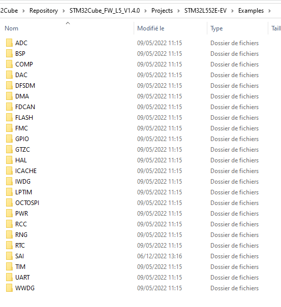

DYann.1
DYann.1Author
Senior II
January 9, 2023
No my board is 'STM32L552E-EV' but I don't have a example I2C with this board :
