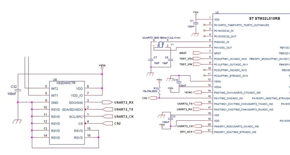

AGasp.1446
here a part of the schematics and reading code

waclawek.jan
I don't see anything suspicious here...

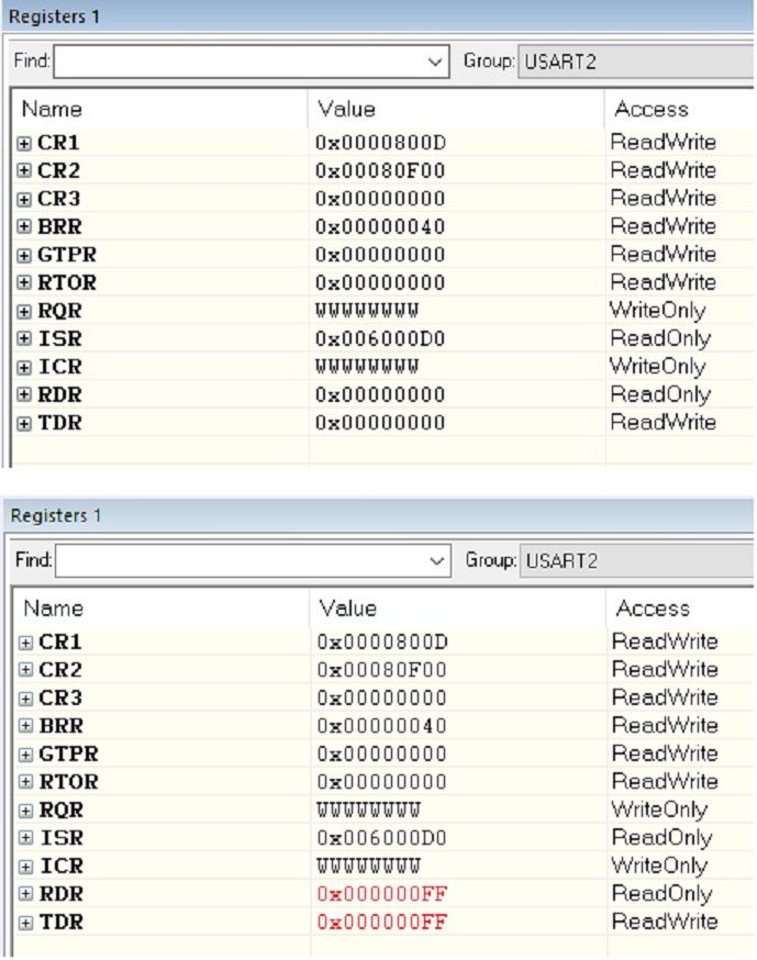

AGasp.1446
here the the USART2 registers condition before and after tx/rx operation; as a 2nd byte is transmitted, in this case i wrote 0xff. If I write 0x00, RDR an TDR will be 00 in the second screenshot.0693W000003Qfq2QAC.jpg
waclawek.jan
I can't see anything suspicious here either.
