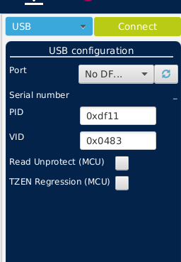

I just did what you said:
- Set the BOOT0 signal of the STF32F107 component to High using the jumper on my board.
- Reconnected this board to the USB of my PC. A LED is lighting meaning the board is powered up but I still don't hear any connection beep when I insert the USB cable into a USB slot on my PC (this slot is working with other devices)
- Started STM32Programmer, chosed "USB" click on "Connect" but still nothing happens, I get the error message "Error: Establishing connection with device failed", screenshot attached.
Can you help ?

Just - your PC has to "see" the new USB device - otherwise nothing will happen.
So try other plug, cable - until you see it (in device manager ) or get ding-dong...
+ set jumpers boot0 hi , boot1 lo.
is you clock /crystal on board:
check it.

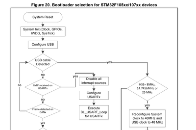

+ read AN2606 ...

Now it works !
CubeProgrammer has managed to connect to the chip.
I had in fact, by mistake, raised to 1 the wrong pin of the component (Boot1 instead of Boot0)
