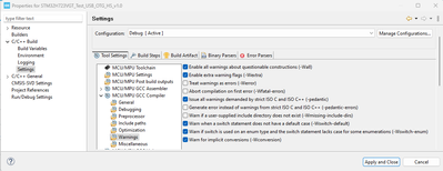

In another attempt to find a clue, I changed the compiler preferences to show all possible errors and warnings, see picture below:
Building the project with this configuration resulted in a shocking list of warnings, many signaling casting issues. Checking on the files involved, I detected a function with useless content, see below:

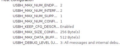

+ did you enable the built in debug messages ? Maybe its helping...
in Cube : USB settings ->
9 REPLIES 9

First: you cannot debug a running USB connection, because it has a fixed timing and the moment you stop it, to see what it's doing - it's over, some timeout hits and nothing working anymore.
So you can: enable debug messages, to get some info what's going on, or use a tool, to record the running USB transfer and see what happens.
But never stop it by debug and expect it to run on then.
And if you setup the USB correctly, it will work, no need to look at some registers.

Warnings: newer GCC compiler versions produce more warnings and they are enabled by default. Since this is not your code and you have no clue why the warnings, just disable them for now (but note for later).
