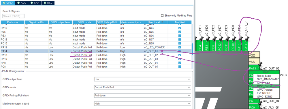

I cannot use SW pins as GPIO for some reason
Javier1
Principal

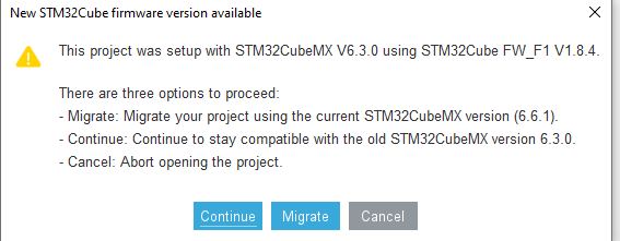

I swear i was able to do this in the past but then ...... then i updated from 6.3.0 to cubeMX 6.6.1.
Maybe thats the reason, maybe not .
 0693W00000WJQkaQAH.pngIm using a stm32f105RBT6
When i flash the chip and remove the stlink both PA13 and PA14 are stuck into some idle 1,3V floating state instead of toggle each second like PA10
I am not sure where should i look to be sure pin SW functions are not on.
Setting up pins as GPIOs in cubeMX
Code inside main, simple GPIO toggle

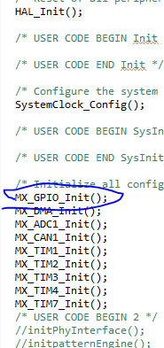

int main(void)
  /* USER CODE BEGIN 1 */
  /* USER CODE END 1 */
  HAL_Init();
  /* USER CODE BEGIN Init */
  /* USER CODE END Init */
  SystemClock_Config();
  /* USER CODE BEGIN SysInit */
  /* USER CODE END SysInit */
  MX_GPIO_Init();
  MX_DMA_Init();
  MX_ADC1_Init();
  MX_CAN1_Init();
  MX_TIM1_Init();
  MX_TIM2_Init();
  MX_TIM3_Init();
  MX_TIM4_Init();
  MX_TIM7_Init();
  /* USER CODE BEGIN 2 */
  /* USER CODE END 2 */
  /* Infinite loop */
  /* USER CODE BEGIN WHILE */
  while (1)
	  HAL_Delay(1000);
	  HAL_GPIO_TogglePin(uC_OUT_01_GPIO_Port, uC_OUT_01_Pin);
	  HAL_GPIO_TogglePin(uC_OUT_02_GPIO_Port, uC_OUT_02_Pin);
	  HAL_GPIO_TogglePin(uC_OUT_03_GPIO_Port, uC_OUT_03_Pin);//Only thisone works
    /* USER CODE END WHILE */
    /* USER CODE BEGIN 3 */
  /* USER CODE END 3 */
I am flashing the release version wchih is not supposed to be using SW debugging pins at all..... i ran out of ideas

Thanks @Herve PIERROT​ , ill give it a look to AN4989 and get back to you with my findings.
What troubles me is... i never had this problem before untill now, and im using both SW pins as alternative functions in the same hardware with other projects.
Ill downgrade to cubeMX 6.3.0 also
Available for consulting/freelancing , hit me up in https://github.com/javiBajoCero
@Herve PIERROT​ , i already fixed it , there is nothing wrong with cubeMX nor the firmware package.
I just deleted the project, generated everything again with cubeMX 6.6.1, copied my libraries and now its fine.
Something went wrong when i updated CUBEMX and regenerated the progect, i believe the issue was in the files autogenerated by cubeMX at that point.... but i dont have the time to figure out what, anyway everything is working now.
