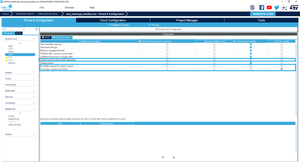

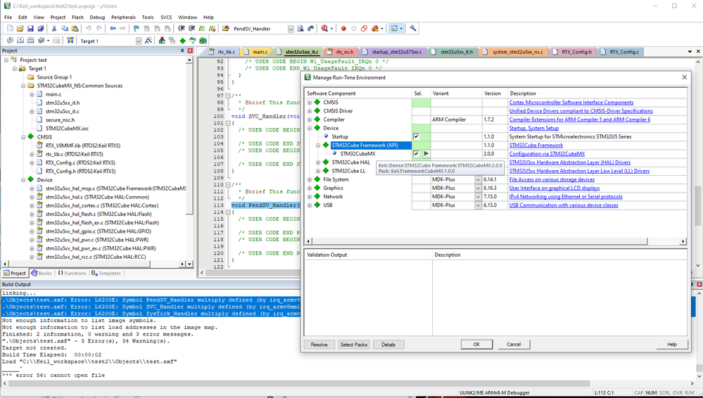

I am using Keil MDK to setup a project for STM32 devices. STM32cubemx is integrated into Keil and can be used to generate a skeleton for the project (main.c, stm32XX.c, .h files and stm32CubeMX.ioc, etc).
This is helpful but some of the generated code contain duplicates of some handlers, like "void PendSV_Handler(void)". How do I stop STM32CubeMX from generating these defines?

If I did understand well the situation; you need that CubeMx stop generating the interrupt handlers, you mentioned.
If so, under System Core --> NVIC --> Code generation you will find the list of all the interrupt handlers. You uncheck those you don't need CubeMx to generate:
Hope this is a good answer to your question. If yes, please select it as a best one else give me your feedback to be able to provide help.

Syn_BE
I have the same problem here.
I use CubIDE 1.10.1 with integrated CubeMX 6.6.1 for STM32G474.
  • I use "my own" FreeRTOS, not the one of CubeMX (Middleware FreeRTOS is "disabled")
  • I use "generate as a pair of '.c/.h' files per peripheral"
As @newdev​ wrote:
CubeMX is generating handler functions (in file "stm32g4xx_it.c") for
  • PendSV_Handler
  • SVC_Handler
  • SysTick_Handler
which collide with the handlers of "my" RTOS.
How can I prevent the generation of these functions in CubeMX?
Best regards, Andy

Hello @Syn_BE​
First, I apologize for my late reply.
Kind regards,
Semer.
This solved the issue. Thanks!
