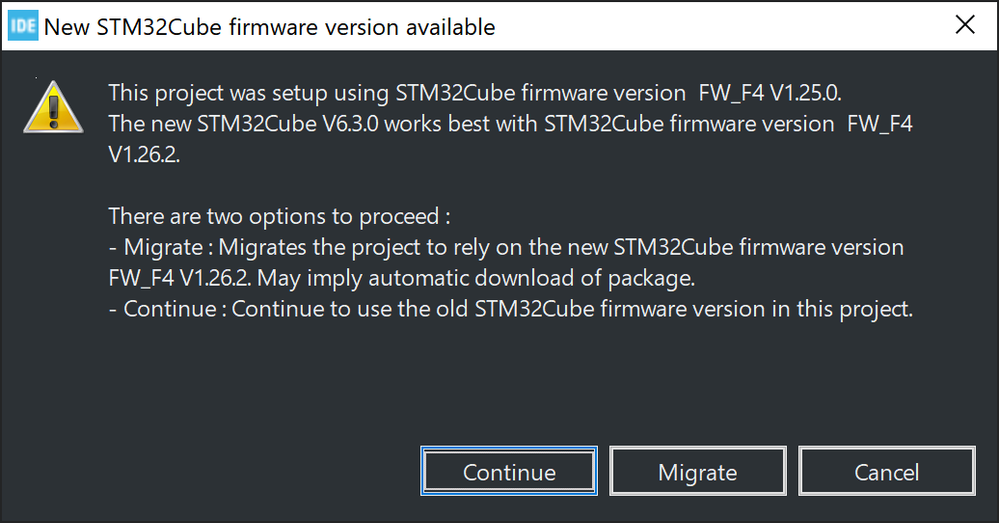

How can I lock the firmware package version used by my CubeIDE project. I do not want the firmware to be updated when I make changes to the MCU pin usage.

Don't upgrade it. Cube won't force you to. The package version is selectable in code generation options.
Well I hope that is true because I have seen Cube update firmware when saving a change in the configuration tool. On the Project Manager "Project" page the firmware version is greyed out, even though I have a couple of packages for my MCU.
You'll get a screen like this. Make sure you don't blindly click through.
Looks like it is not selectable per se. You can only migrate upwards.
OK, that would be good.
If one decides to not migrate and then some time later wish to do that, is that possible in Cube?
I get that popup every time I open the IOC file. So you'll have the option whether you like it or not.
recommend backing up the IOC in version control so you can restore in case you misclick.
Excellent, thanks so much for helping alleviate my concerns.
IOC is always in a git repo so in the event I "click through" that dialog incorrectly I should be OK :)
