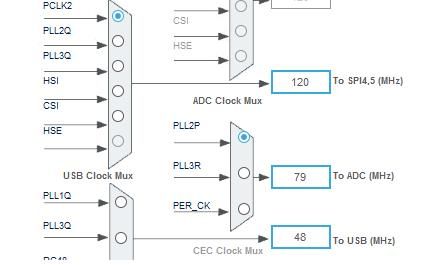

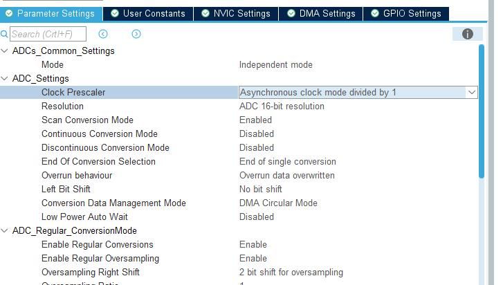

In former CubeMX versions an Clock to ADC of 400MHz was possible
Now I am working on CubeMX V 6.3.0 with STM32Cube FW_H7 V1.9.0.
The maximum Clock frequency I can adjust is now 79MHz (selected clock source is the PLL2)
What is the meaning of the "79 to ADC (MHz)" exactly.
If, it is the input for the prescaler of the ADC, why it is limited to 79MHz

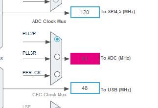

0693W00000DmODcQAN.jpgWenn > 79 MHz is selected, CubeMX shows an error.

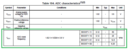

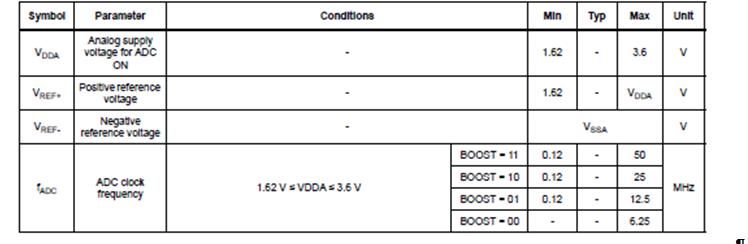

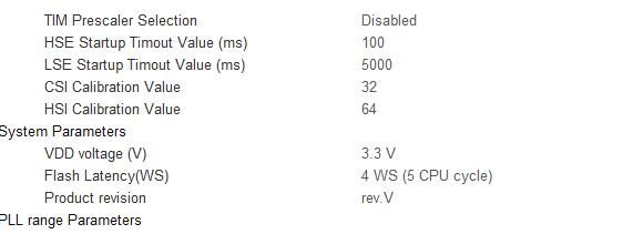

If it is the maximum Clock frequency of the ADC, why is it not limited to 50Mhz as discribed in the datasheet for the V design
0693W00000DmOMJQA3.jpgV-design is also selected

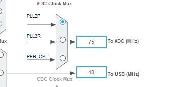

With 75 MHz Clock selection, also an DIV1 is allowed, is there an addition divisior in between ?
Or an Bug in the CubeMX ?
Sep 7, 2021 11:07 AM UTC
It's likely just a bug in CubeMX. They have thousands of chips, hard to get everything right. I wouldn't go past the 50 MHz listed limitation. In any case, the max clock used in thier app note is 50 MHz.
https://www.st.com/resource/en/application_note/dm00628458-getting-started-with-the-stm32h7-series-mcu-16bit-adc-stmicroelectronics.pdf
CubeMX limits it to 80 MHz for me.
Why would DIV1 not be allowed? The clock scheme is shown in the reference manual well.

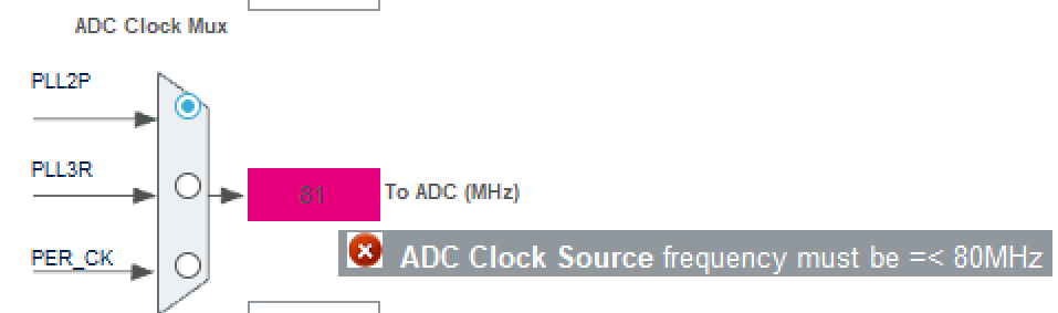

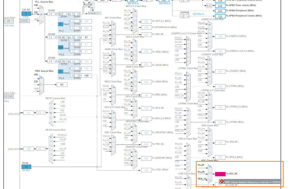

Actually, I assume that what you are observing is the expected behavior of STM32CubeMX.
To explain briefly the cause behind the displayed warning message in clock tree "ADC Clock Source frequency must be =< 80Mhz":

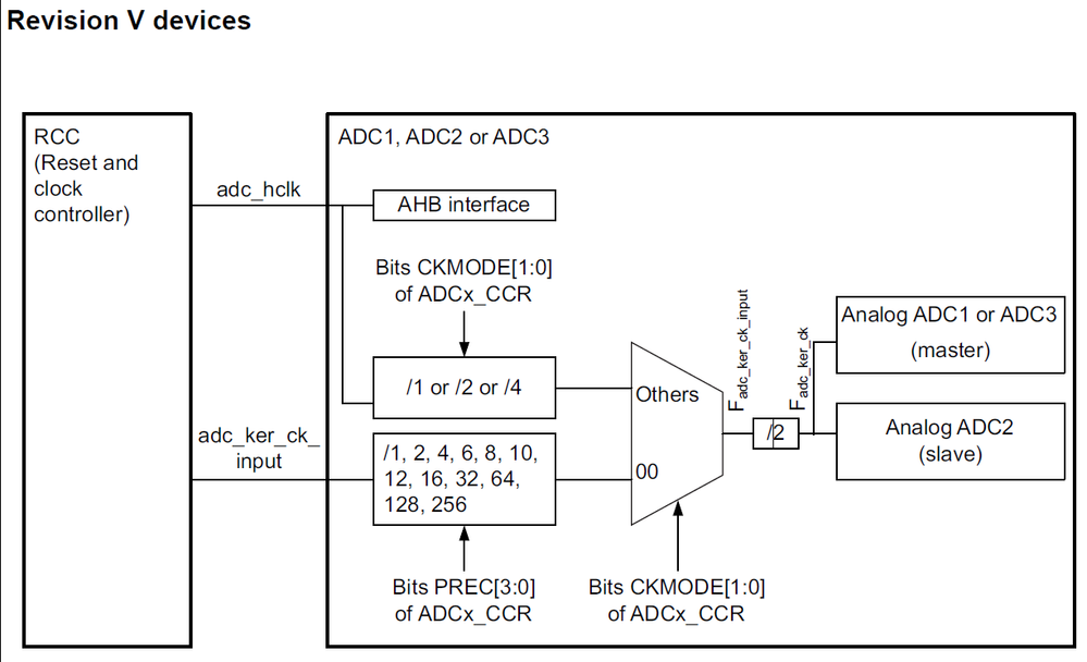

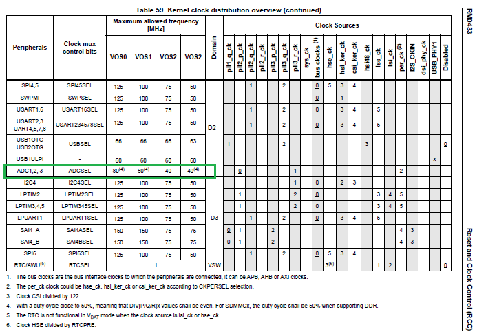

0693W00000DmWyqQAF.pngIn fact, the frequency value you are seeing in the clock tree (which shouldn't exceed here the 80MHz in your case) is the adc_ker_ck, please refer to STM32H743xI/G Reference Manual > Table 59. Kernel clock distribution overview:
0693W00000DmX3uQAF.pngThus, assuming that you're setting your Power Regulator Voltage Scale to VOS0, STM32CubeMX tool is correctly displaying the constraint of the maximum allowed adc_ker_ck.
Then, after dividing this value by the ADC prescalers we should not exceed the 50MHz/ 25MHz/ 12.5MHz/ 6.25MHz which are the ADC internal frequency as mentioned in the STM32H743xI/G Data Sheet > Table 184. ADC characteristics:
Hope this answers your question.
