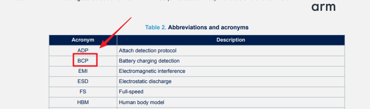

Hi @FBL :
I think there is a typo here.
And I don't find STM32H723, does this chip support BC1.2?

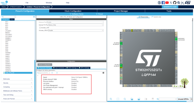

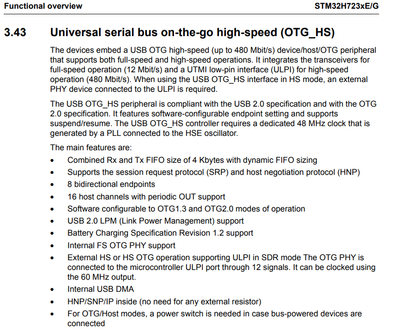

I can't configure BC1.2 in STM32cubeMX, but datasheet say it supports.

Yess, according to datasheet,  STM23H723 supports BC1.2

Hi @FBL :
But CubeMX can't configure BCD, do you know the reason?
