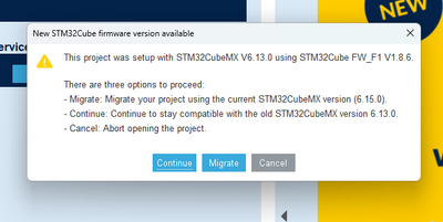

Recently, The CubeMX cannot open IOC files through the file menu, and cannot save IOC files when creating a new project. But I can open the project normally by double clicking an existing IOC file.
Working environment: Win11+CubeMX6.15
I have tried reinstalling CubeMX, lowering CubeMX version to 6.13, and so on, but they all have the same problem.
